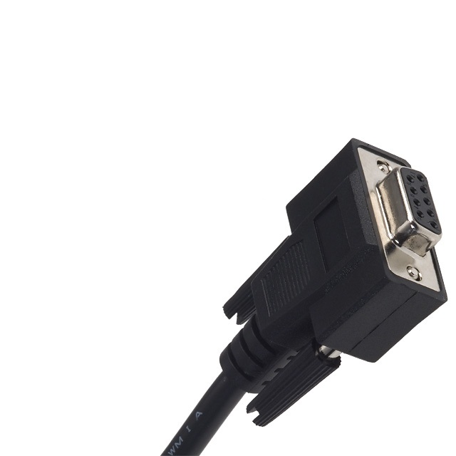

Cannon connectors proved difficult to find. I ended up cracking open an un-needed d-sub computer connector I had in the parts box. See attached photo for an example. I believe Radio Shack sells these connectors themselves [not the entire cable] if you don't have a spare cable.
Either I'm blind or you didn't mention the pin outs for left and right signal. The photo sure helped as I couldn't read the electrical diagrams in detail.
Right = Pin 15 Left = Pin 17. Ground = Pin 16 + 19 [with 2.2K ohm resistor in between]

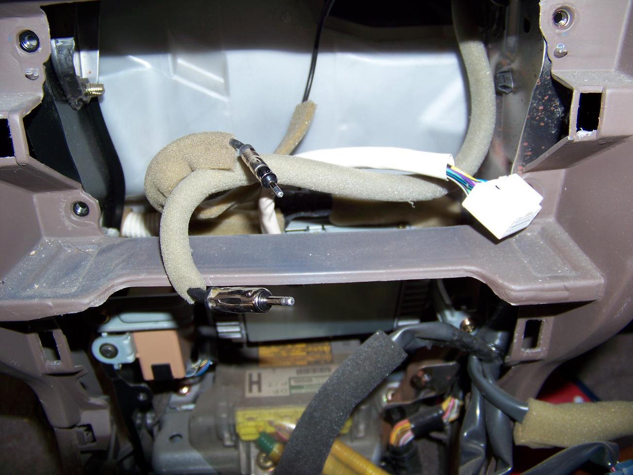

I built the cable and went to do the install in my 04 4Runner.
2006 Scion radio works and the aux cable works great. The problem is, it seems my 4runner steering wheel contols use the same jack as the aux cable would use. The controls jack has blank spaces in it, do you know if the small pin connectors are available so i could add the aux cable into the existing jack??
