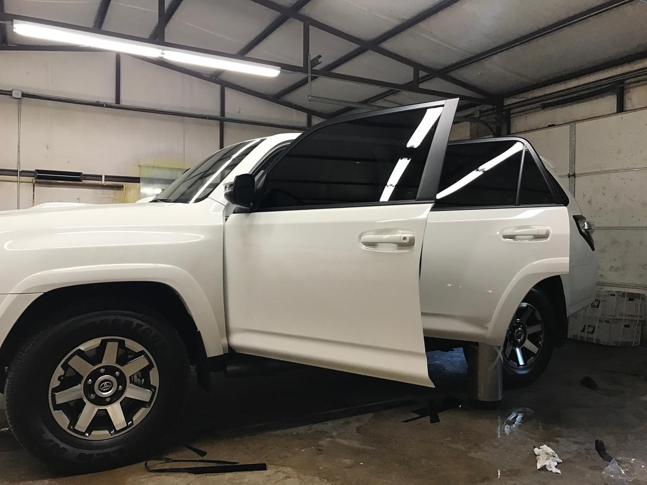

On Wednesday I put in my Weathertech floor liners and Canvasback liners in the rear. I haul two large dogs around with me a lot so these are a must have. Yesterday I got the windows tinted 5% all the way around and a strip across the top of the windshield.

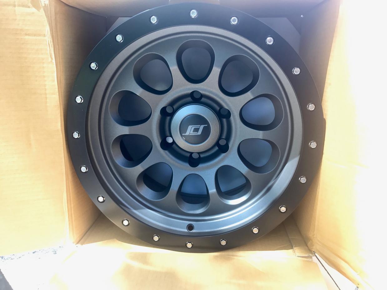

SCS Ray 10's in Gun Metal are sitting in my shop floor ready to go.

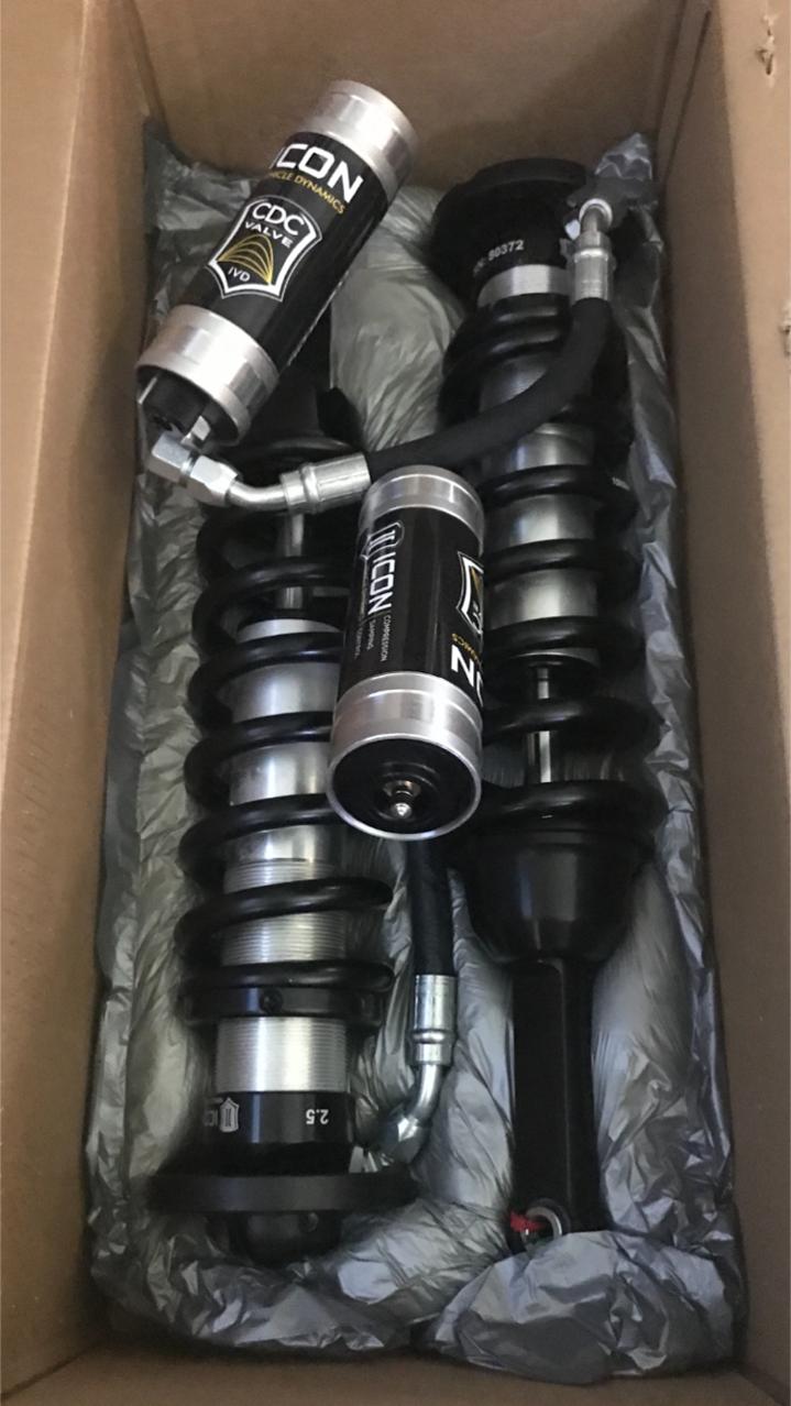

Just ordered a Gobi rack for Scout Runner......maybe I'll have it before 2018. We can only hope. Other than that, I ordered another set of the XD Phillips 4300K HIDs to install. I got some of the interior LEDs put in today. Im hoping to start installing the Icon coilovers tomorrow.

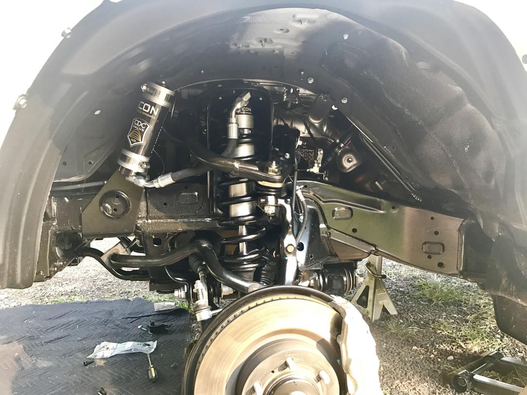

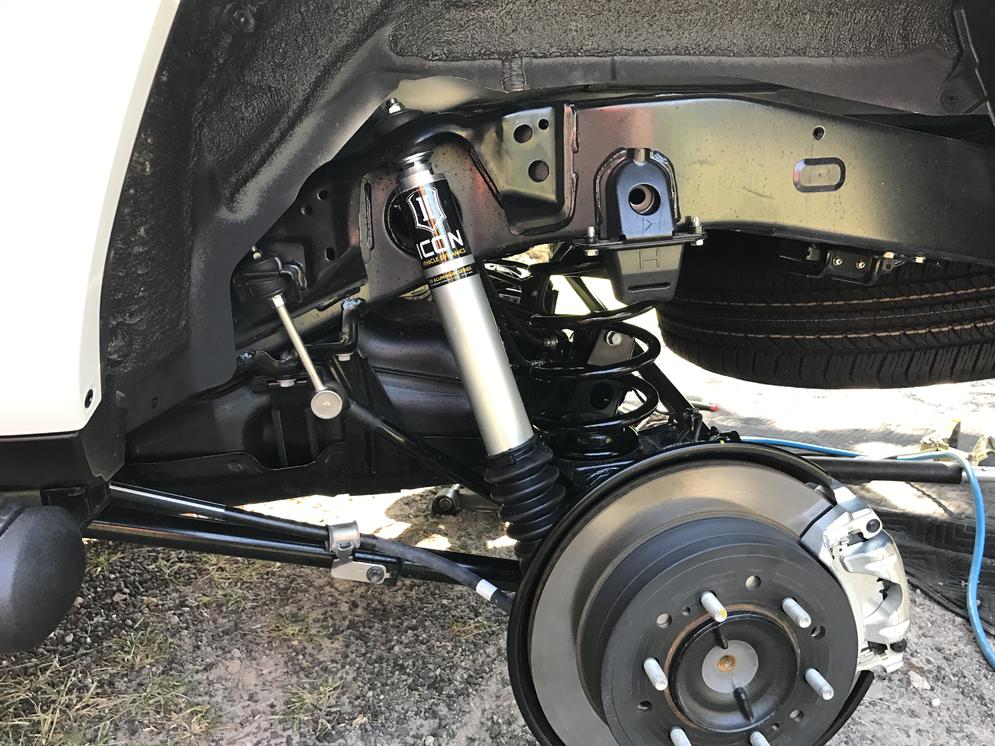

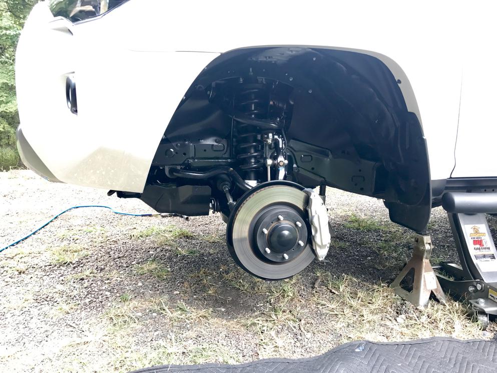

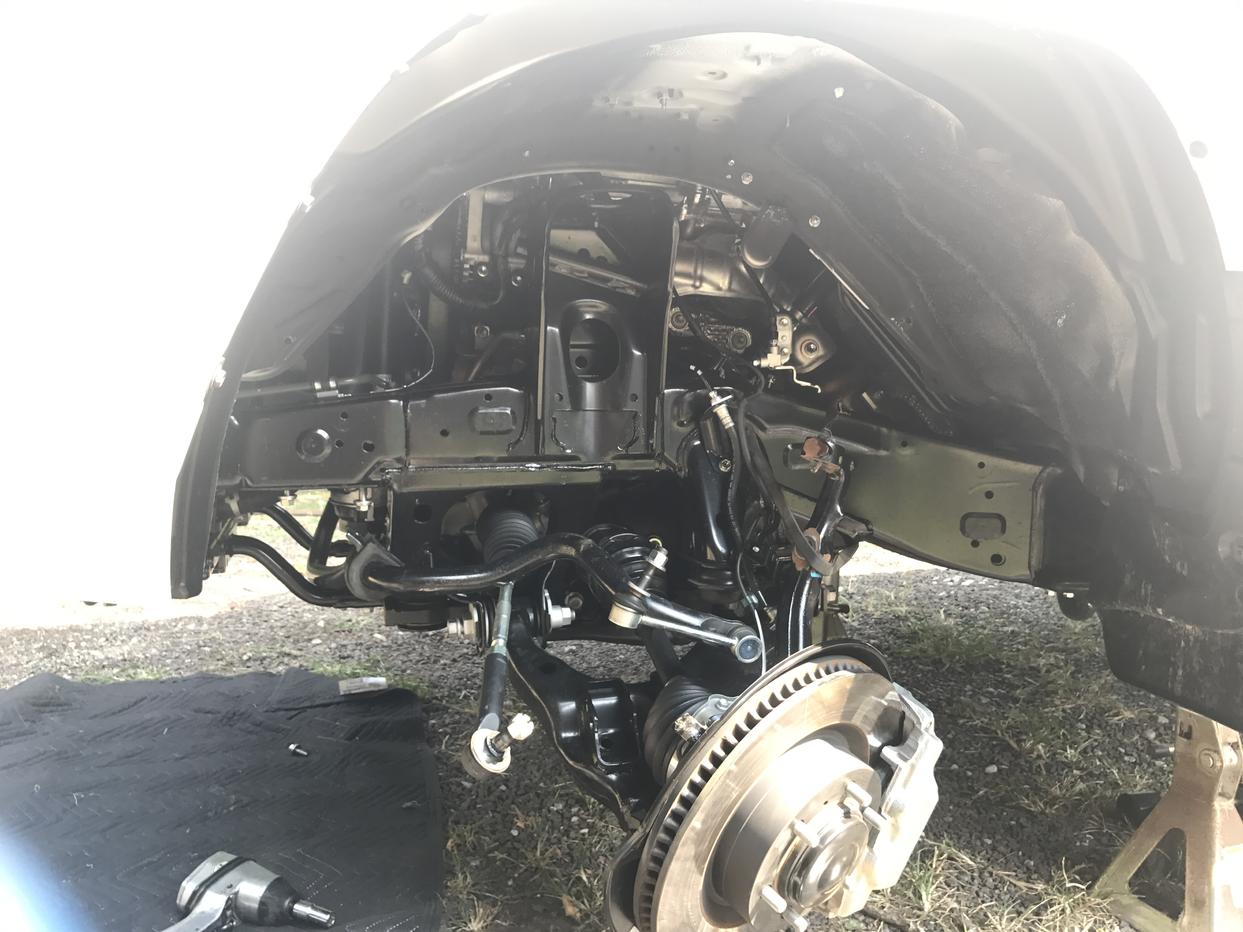

Getting started on the lift kit. Had to pick up a new floor jack from Harbor Freight this morning. My tires and UCAs showed up about an hour ago. Hopefully this goes smoothly. I have air tools so that should help some. Scout Runner only has 422 miles on the odometer and already getting torn apart.

Got the drivers side done. Passenger side should go a little faster. No real issues. Just time consuming.

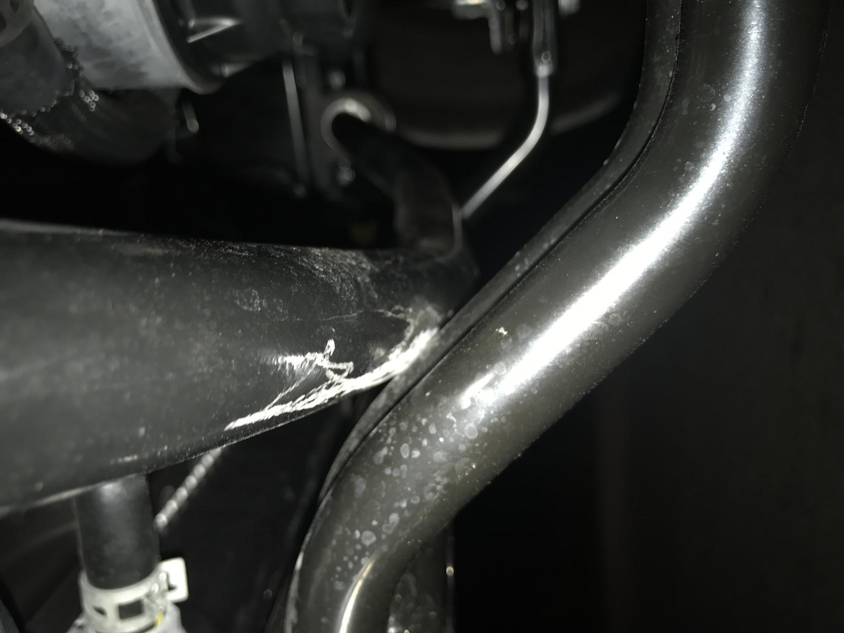

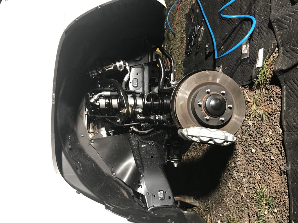

Ran into a small problem. The sway bar is rubbing on the driver's side. I can't get the bolts back in it either. The passenger side is fine and the bolts went back in with a little persuasion. The driver's side isn't even close and it can't go any further forward because it's already hitting the other piece shown in pic. I guess I will give Icon a call in the morning. I went ahead and drove it down the road a bit. Everything else seems fine.

I can't tell what the sway bar is hitting, radiator support? If so, it's a common problem, Google lead me to the solutions.
Non-KDSS right?
Non-KDSS right?
Yes it was the radiator support. I put 2 washers in the the front of the support on the driver's side. It gave it enough clearance for the sway bar not to hit the radiator support. Hopefully my RCI skid will still fit up ok.

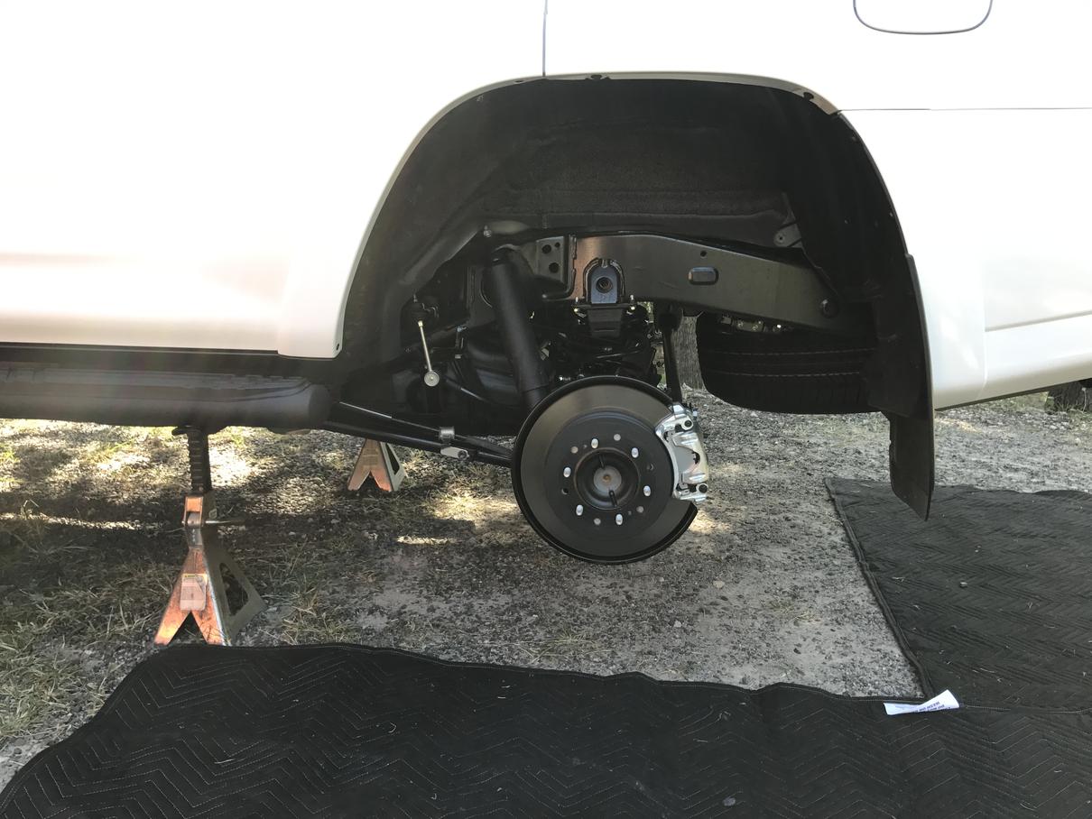

Got started on the rear this morning. It was pretty easy other than getting the track bar back over far enough to get the bolt back in it on the driver's side. The 2" springs weren't too much of a pain. I did it alone, so it's certainly doable with one person. Now the 3" Overland springs, those might be a two man job. I'm hoping to get the wheels and tires mounted today provided that I can find a set of black lug nuts in town. I went ahead and did the fender liner mod this morning on the front.

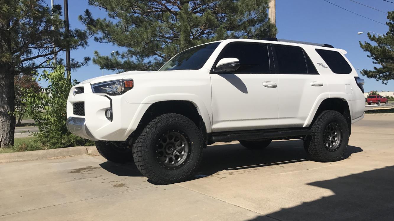

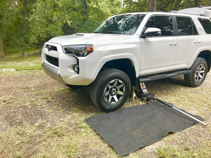

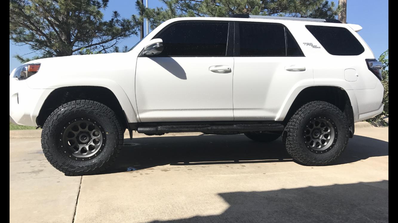

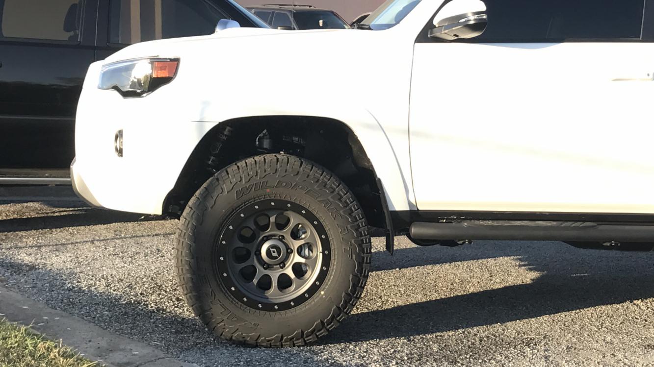

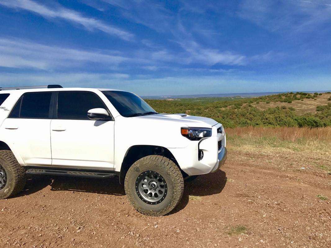

Wheels & tires are installed. It looks so much better now. I will probably turn up the Coilovers about 2-3 more turns on each side. The rear should settle a little also. I'll get some "after" measurements and post them with the before measurements.

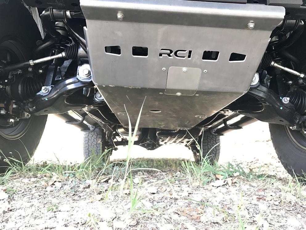

I was able to get the front two RCI skids back on yesterday evening. I still have to install the new steel cross member and skid in the back. I ordered a set of Morimoto 4500K HID low beams. Those should arrive in a day or two and I'll get those installed.

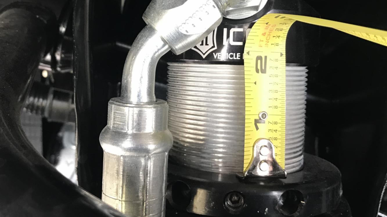

I had some people asking me how much my Coilovers were turned up now since my last adjustment. I took this pic to show how many of the threads I had showing. As it sits now, I'm right at 3" over stock height. Icon says not to go over ~2" of threads showing. I got it aligned yesterday and it came out perfect. 3.9 degrees of caster and toe/camber perfectly in spec.

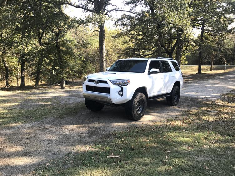

The front as it sits now. Still has about 1/2" of rake, but maybe the rear coils will settle a bit.

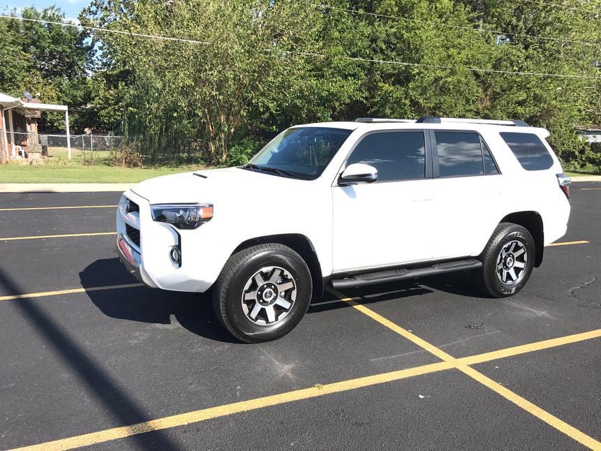

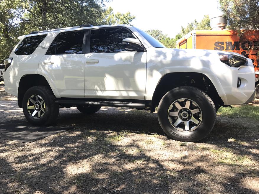

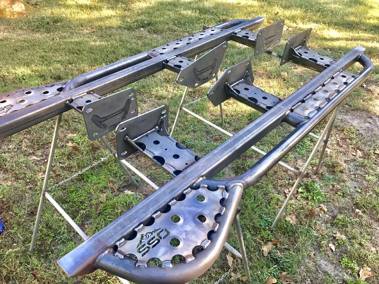

My SSO sliders arrived last week. I got them primed & painted (rattle can) and installed a few days ago. It's just personal preference, but I like these much better than the RCI sliders I had previously.

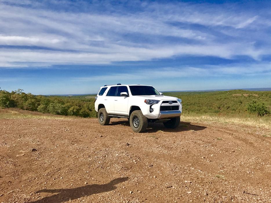

Took a short drive today to a private ranch/off-road park that recently opened up not far from where I live. It was much better than I expected. Got to do some moderate rock crawling, some steep incline/declines, water crossings, and as you can see in the pics, amazing views. Today was the first time I actually tested out the crawl control features. I had always thought it was somewhat of a gimic/useless BS, but I was very impressed with it. I set the speed to medium and the terrain to max or "large" and it crawled right up a 80 yard stretch of steep incline with very large rocks (basketball size) all throughout. It's not a feature I'd probably use on a more technical section, but it worked very well.
