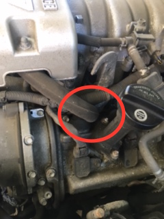

I have a 2004 V8. I used this particular hose because I saw it referenced on another thread.
This is a picture of the driver's side of the engine.
The circled part is where the hose attached to the valve cover of the engine. It pulls off very easily, but the inside diameter is pretty small. You will likely need a funnel.

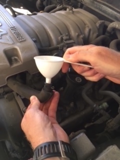

Here is a pic of the hose removed with the funnel in.

I had my son start the engine and I slowly poured the Seafoam into the funnel. The RPM's jumped up and down as the engine computer adjusted to the Seafoam. My son didn't have to touch the gas pedal to keep it running but I can certainly see how you might flood the engine if you pour too fast. I can recall mine almost died when I accidentally dumped a bigger splash into the funnel. My GM mechanic buddy told me they try to keep the RPM's to 1500. Whether you can do that or that it even matters on a Toyota I cannot say. Just keep in mind that the engine will start smoking while you are doing this. Nothing like afterwards when you drive it around, but plenty enough.
When I felt that the bottle was almost empty I gave my son a heads up to turn off the engine on my command. As soon as the last bit poured into the funnel I told him to cut the engine. Then left it to marinate for 10 minutes and fired it up and drive it around town. It was a smoke show. I did not get any warning lights, though I wondered if you actually flooded the engine with too much Seafoam that the computer would throw a code. Mine didn't. It took about 4-5 miles of driving for the smoke to completely go away.
