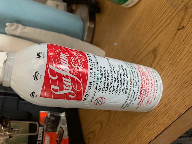

How do I use this in my gas tank. Fill up before I use it? Let it be at half full or completely dead ? Appreciate the help
I should prob put the picture here

Straight from their website
DIRECTIONS
For regular fuel system maintenance, add 1 ounce per gallon.
For cleaning, use 2 or more ounces per gallon – the more you add to fuel, the better it cleans! Add when the tank is low to maximize cleaning concentration.
For injector cleaning machines, use 50/50 mixed with gas.
Use 100% Sea Foam for diesel injector cleaning machines or when priming diesel fuel filters.
For 2-stroke pre-mix, add 2 ounces per gallon.
When stabilizing fuel for storage, use 1 (one) ounce per gallon of fuel. Sea Foam works to stabilize stored fuel up to 2 years.
Haven’t used this before but usually with this type of product you want gas in there - so either half full or full plus how ever much you want to add
No reason you couldn’t do the opposite - put that it in and then add the requisite amount of gas, but you don’t want to run the engine too lean with just the additive
I've been using Seafoam for decades in my older truck & motorcycles.
Buy Seafoam. The next time I fill up with gas, I pour in the correct amount of Seafoam, then fill tank with gas. Drive.
Sent from my SM-G955U using Tapatalk
adding it first to any level of fuel in teh tank is best, it helps to mix it when you add the gas after putting the seafoam in. read the directions on the can for how much to add & other ways it can be used.
for higher mileage vehicles you can do a top engine cleaning by adding it via a brake booster vac line & letting it sit for 15-20 minutes then starting & driving under heavy load. it can also be added to the oil 50-100 miles before an oil change to help clean out internals of the engine.
ive also been using it for decades & it works great for cleaning & maint & also is a great stabilizer if you store any cars or small engine equipment over the winter.
