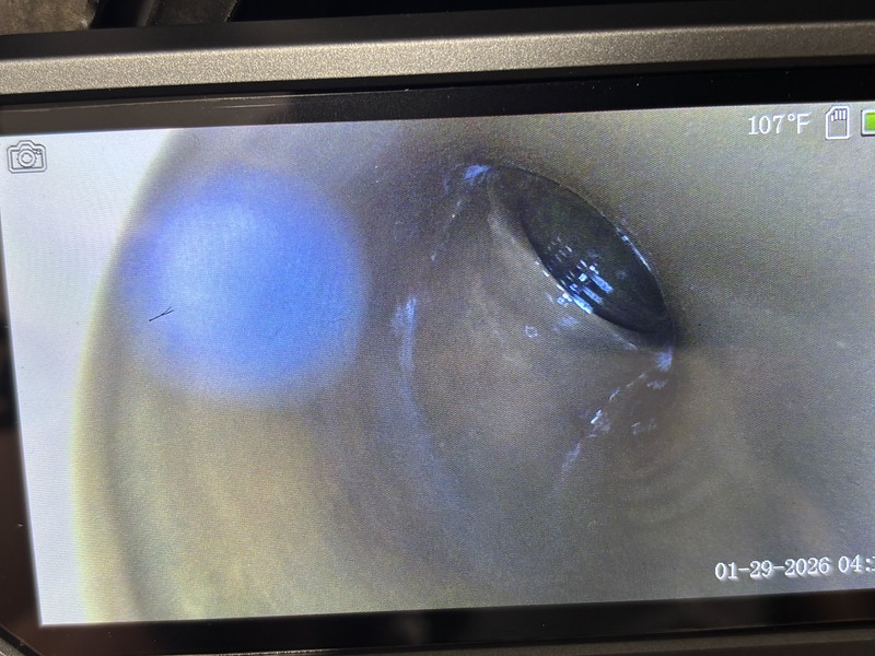

2007 V6 100k miles no check engine light, no codes in OBD2. Last 2 times I tried to fill up at gas station pump stopped before a full tan, second time tried to force more in but filler neck filled up and overflowed on to ground.
Seems like a venting issue but need help to diagnose whether this is the charcoal canister or something else.
I put an endoscope down the neck to check for blockages and took this pic does this look normal?
Untitled by manchesterseller, on Flickr
What else should I check before ordering a charcoal canister?
What is that blue thing in the pic? I had a problem with my third gen and it was a cap from an injector cleaner bottle that had gotten into the fuel fill hose. I cleared it by taking the hose off the tank.
The blue thing is the light from the camera scope I put down the fill tube :) best tool ever btw!
