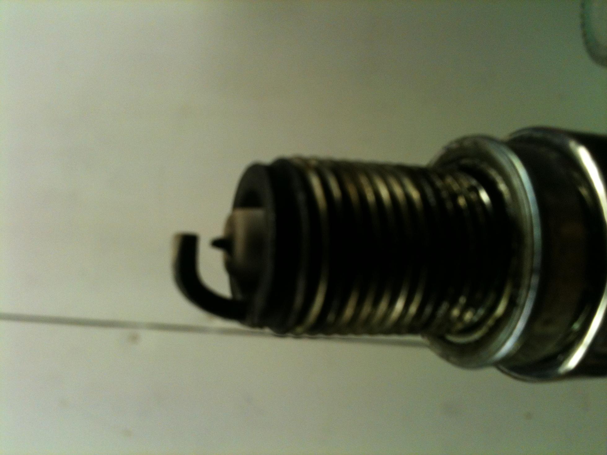

I purchased a 96 Limited 4Runner a few weeks back with 182k. And decided to try seafoam a shot. I followed the websites instruction for inducting through the vaccine system. Got a big cloud of smoke, the nothing on the 2-5 mile recommended drive. Car ran what appears to be more responsive. So when I got home I decided to check the intake, sorry no pics, and it was noticably cleaner. Why stop there, lets check out a spark plug or 2. So I pulled the easiest one. Well it looks as though they are old, no electrode left. I do have a pic of that and don't worry, NGK won't be going back in after tune up. While the plug was out, I shined a flashlight down the hole to inspect cylinder and noticed the top was black. Almost soothe. Is this normal? What can I do to correct this. I am going to seafoam oil in a week, will that take some of the build up away

Its good the cylinder top is black. Its carbon and is a offspring of combustion between gas and oxygen. If it was clean it'd be bad (coolant leaking in).
Yes, thank you Singtoe. I will be purchasing twin ground plugs. I know that these came with different plugs on the heads from the factory. Anyone see any issues sticking to the OEM twin grind all the way around? As opposed to one brand in left bank and different brand in right bank (as it was delivered back in the days.
