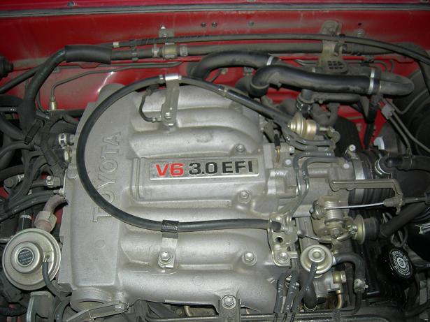

Ive read and searched and searched and read some more but still cannot find where this damn vacuum intake line thingy is where Im supposed to pour the seafoam in my 3vze engine.
Can someone please show me which hose I am looking for in the image below?
Thanks an advance!!
ps, I have more detailed images of each of the 4 corners of the image attached

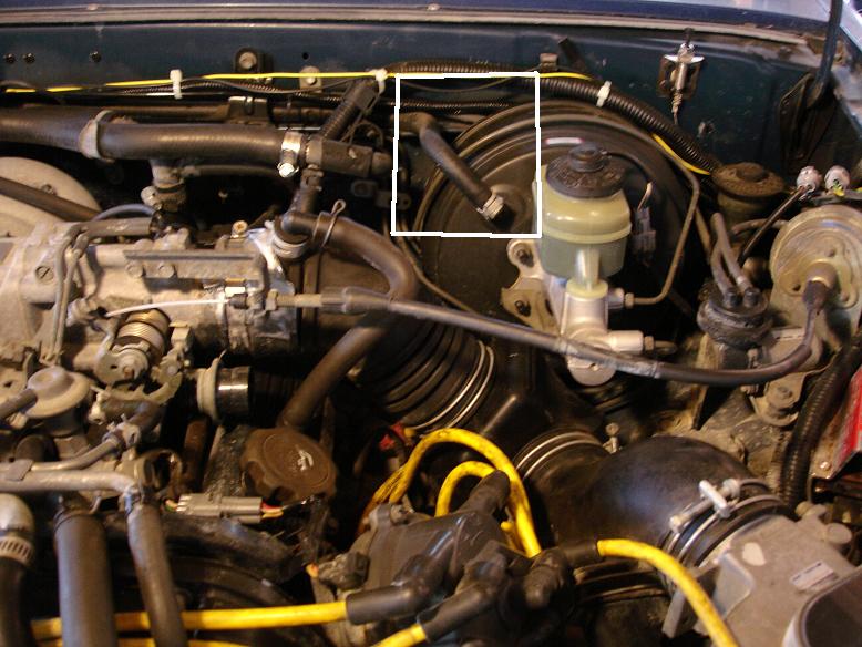

the vacuum line on the brake booster is a good one to use
