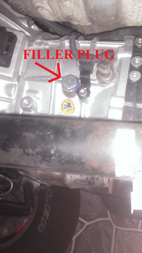

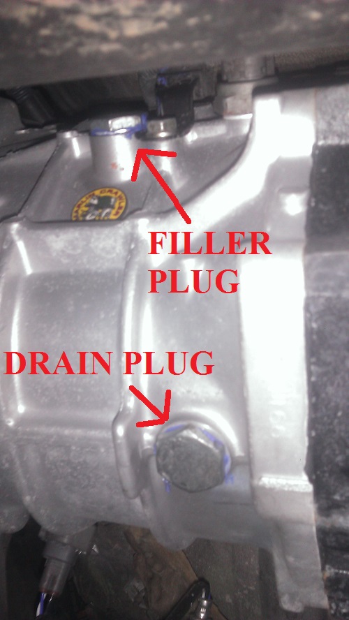

5 speeds will NOT have a dip stick. there is a bolt on the side of the tranny where you fill it. Hold on I will post a pic up in a few, I have the same tranny as you.
It is NOT a sealed tranny.
Here are pics that show the filler and drain plug on your transmission.
Both plugs are visible if you crawl under the driver's side and look at the side of the trans housing on the W59. Should be a 21MM if I remember right.
