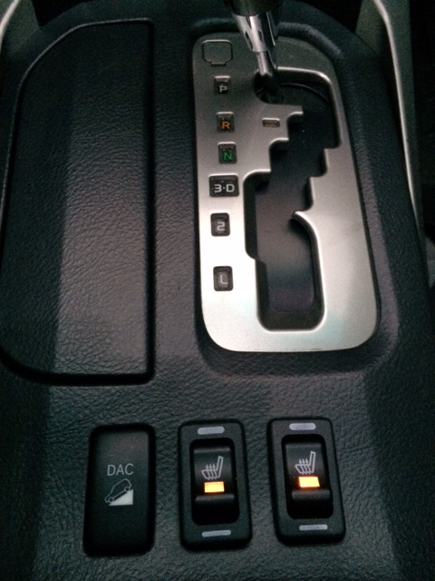

I bought this kit of ebay and installed them last November. The switches fit into the blanks in the center console (next to DAC) with just slight modification. Seats get hot within 2 min and the switches have an orange/amber led light on them to indicate they're on.

Can you post a pic of how he switches went into place.
Here is the pic of the switches installed. Also, this write up was very helpful during the install.

Holy cow, those switches fit perfectly. I wonder if all vendors use the same size switches for their bun warmers!

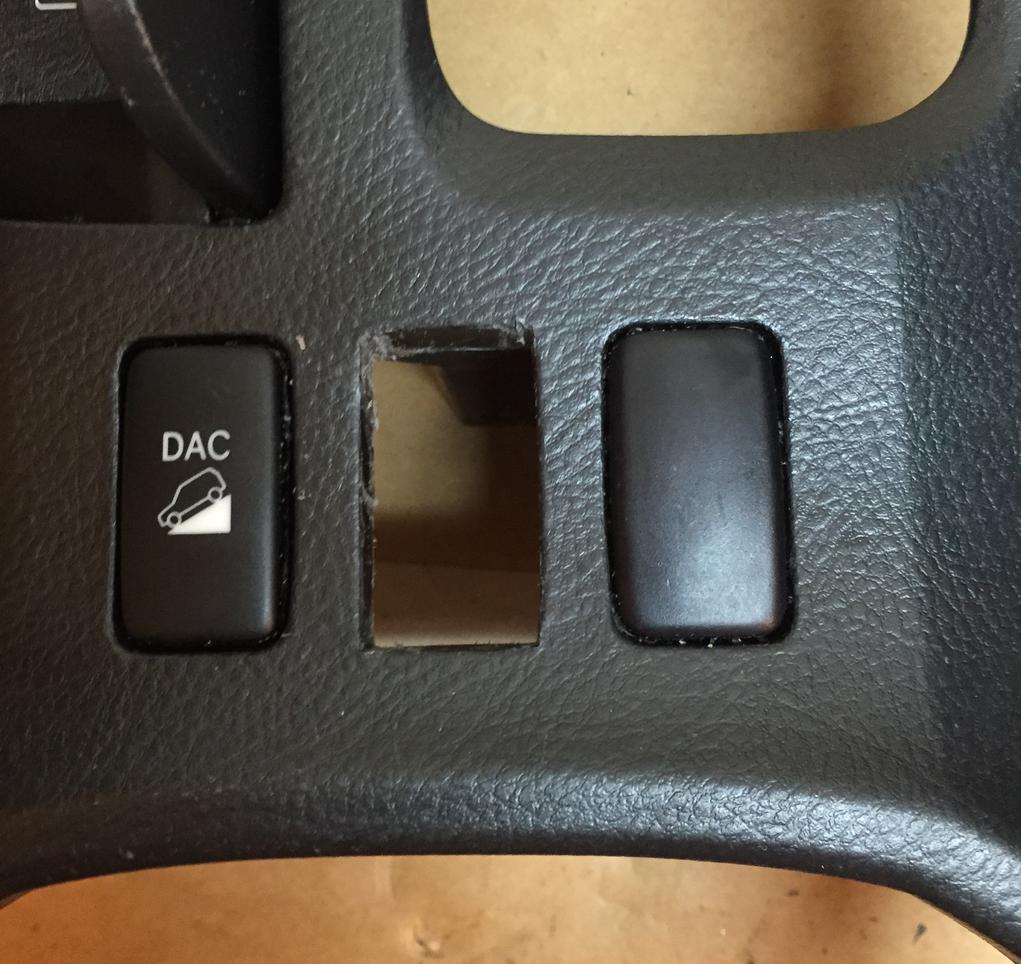

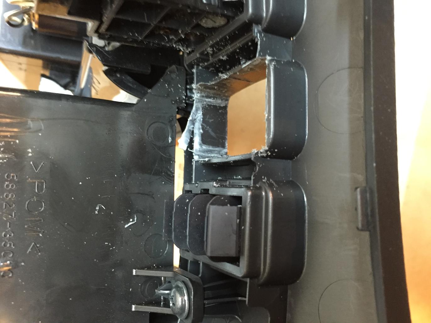

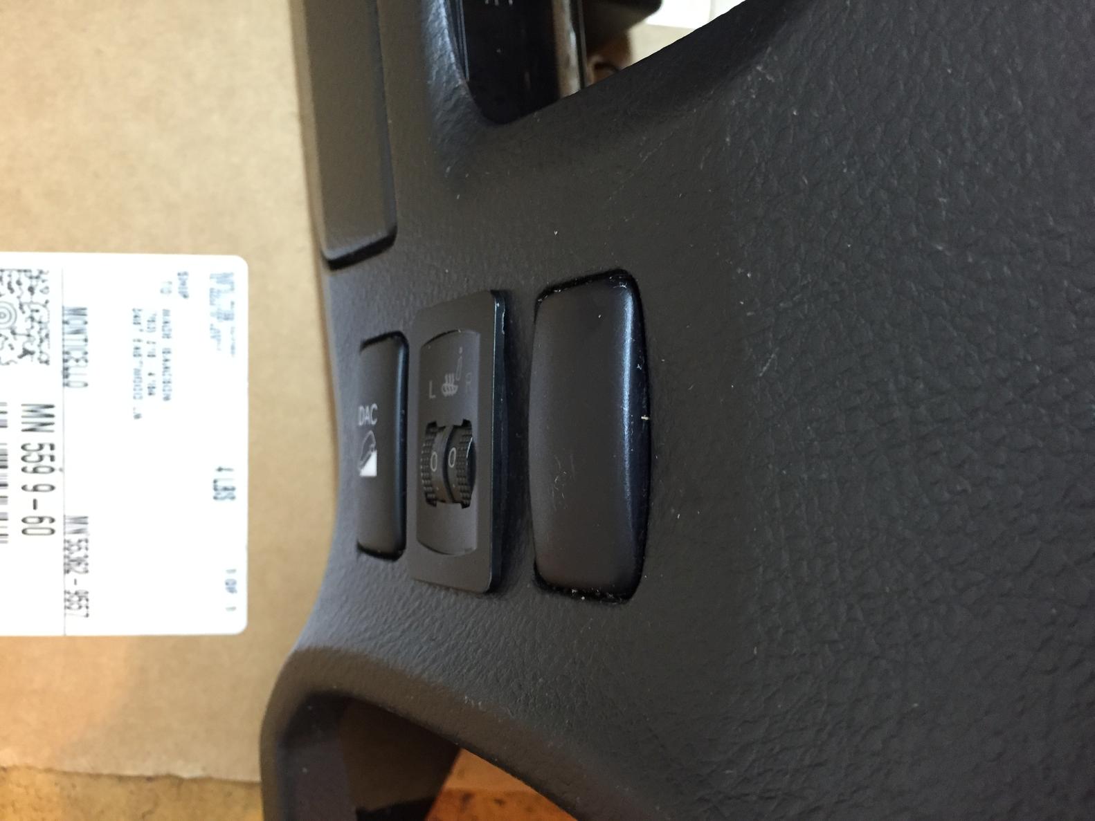

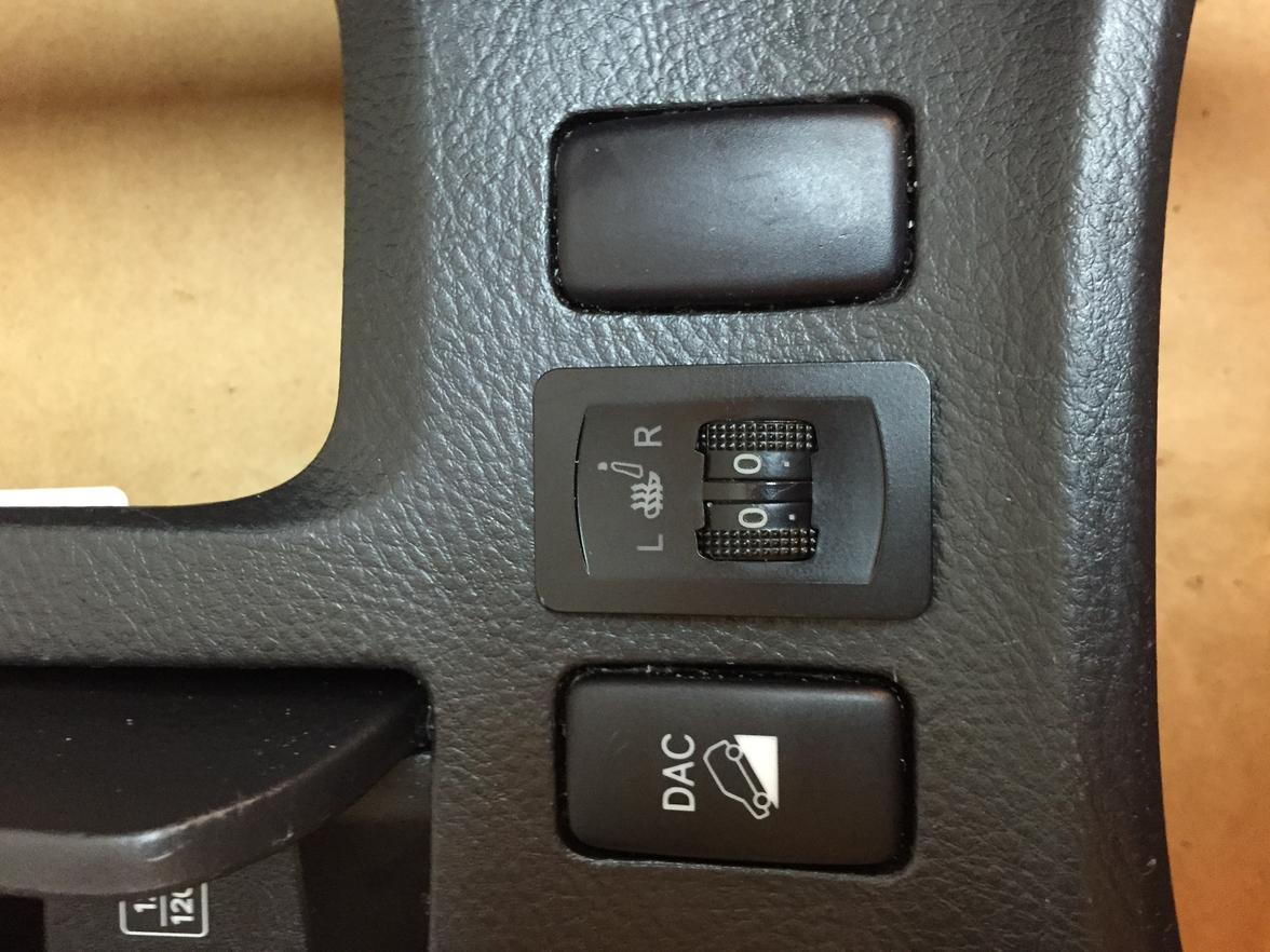

I took some pictures of modifications I had to make to the hole in the console to fit the Rostra Dual Dial Switch. Basically, I had to square off the corners and cutoff the lower part of the hole where it gets smaller. The the switch fits nice and snug now.
Excellent work!!

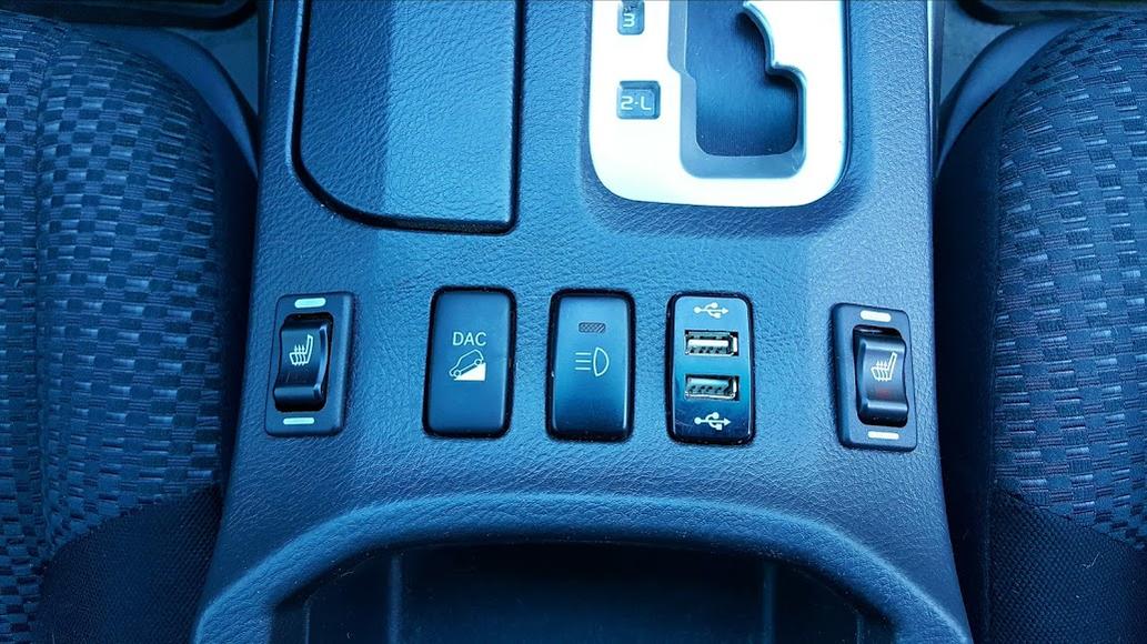

Way old thread, but thought I post up a variation of the install using the same switches but in the factory positions:
