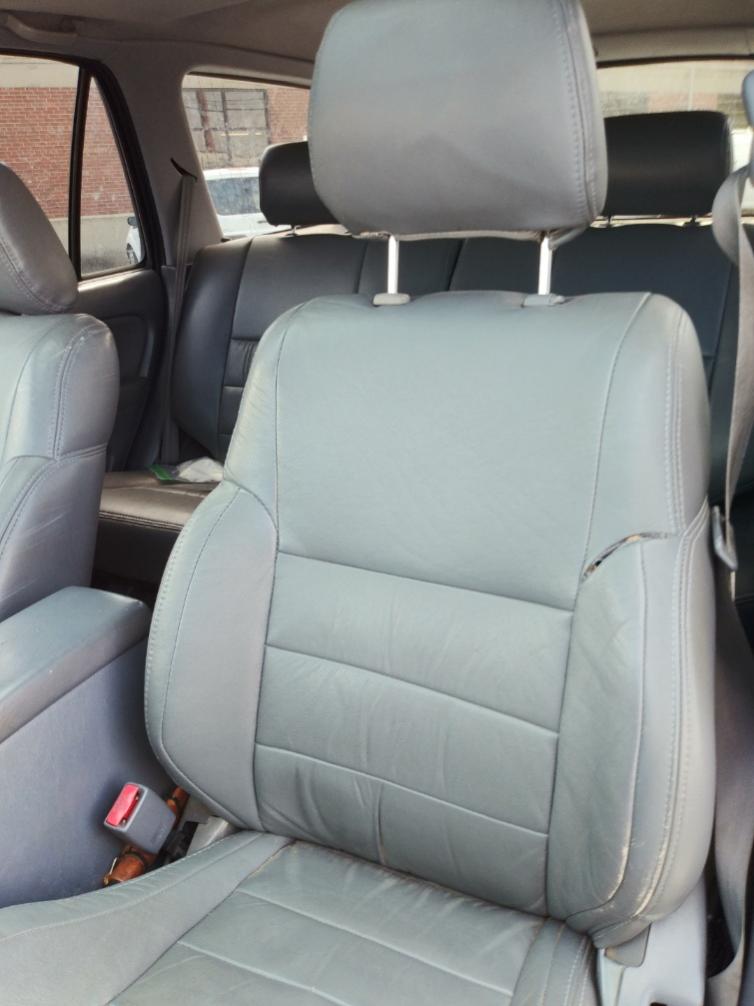

Here's a couple of the 2000 SR5 with dealer installed leather seats.

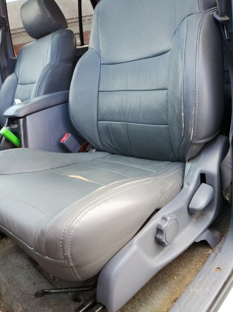

'97 Sport cloth seats:
You can also check part number differences on toyodiy.com or other parts lookup sites. You'll want to check if the foam is different between "sport" option and the Limited seats.
-Charlie
I have a 99 SR5 with leather and those look like my seats, though I recovered my driver's seat already and put down new foam. Best $$ I've spent on the truck thus far.
OEM sport leather is the same as Limited leather.
The only difference(which really isn't) is that 96-00 Limiteds have the lumbar switch on the outer facing side of the seatback vs the Sport leather which has a manual lumbar lever on the inner facing side of the seatback.
