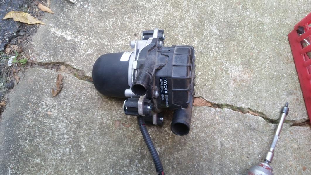

Fixed today with Dorman 306-010 Air pump for a 2000 pontiac grand prix 3.8
Also replaced the intake gaskets while I had it off so I knew it would seal back up good.
Cleared codes and now works PERFECT, everything including gaskets was around $150 at Oreillys and it took about 3 hours total.
For most people Id say 4 hours would be plenty of time to complete this.
Everything is plug and play

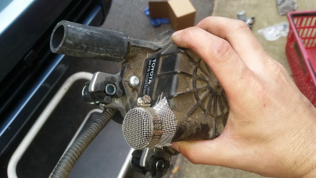

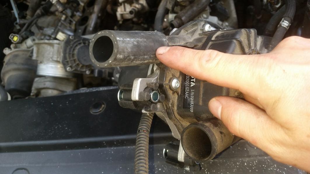

The hose Im pointing at was dry and cracked I replaced it with 3/4 heater hose
And the hole that is open that the pump sucks from I covered with wire mesh used to screen porches and put a hose clamp on it to prevent any large debris from entering it witch I found was what cause my pump motor to fail the first time (mice).

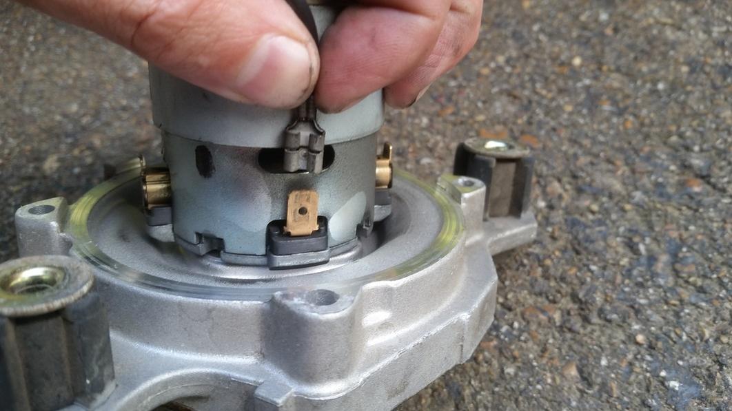

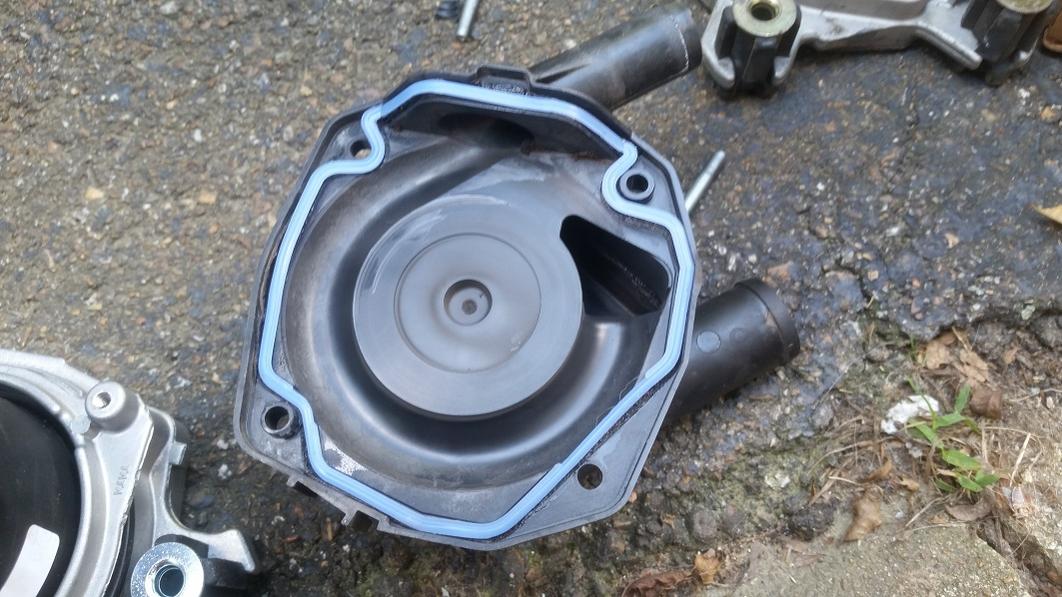

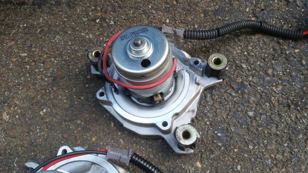

The wiring is the ONLY difference, you can simply unplug your harness from your old pump motor and plug it right in to the new one.
Also no special tools are required, basic hand tools will get the job done.
The only thing some people might not have is a T25 torx bit that you will need to remove the pump cover and swap to the new pump.
