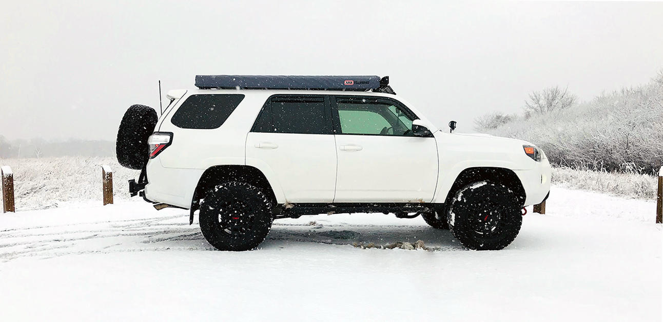

I have 5100s in front set at 2.5 and the RCC2.0 in back and love them. Netted a hair over 2" of lift. I also have a swing out carrier on back which is only 50 extra pounds or so with the added weight of a full sized spare (I removed my factory spare underneath)
