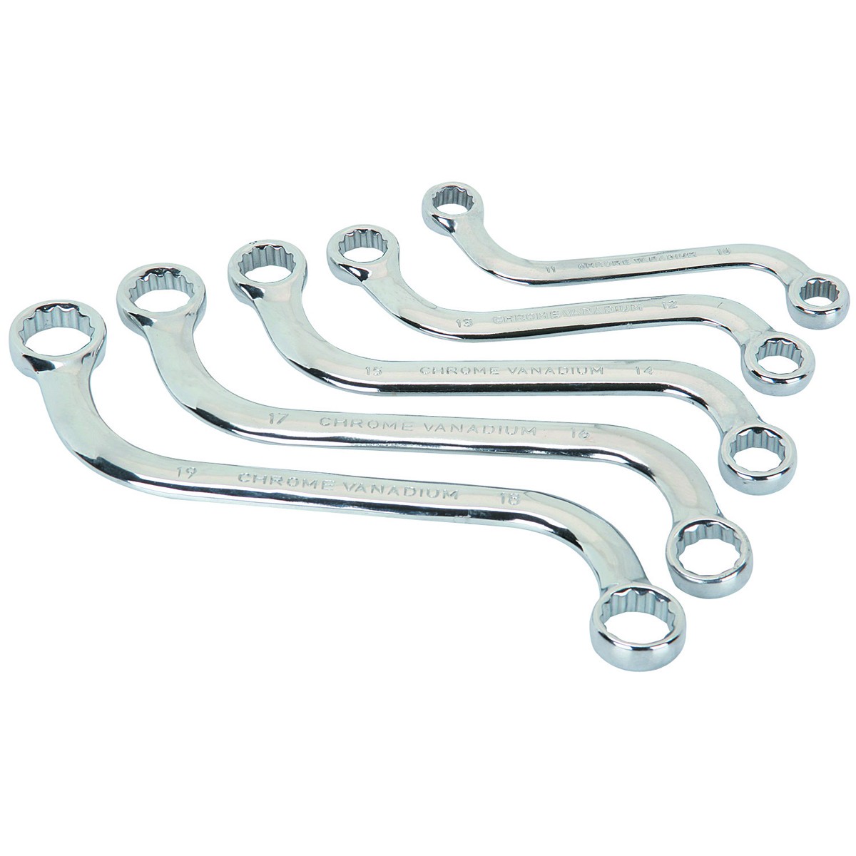

For those hard to reach bolts, I found these curved wrenches to be really helpful.
These wrenches look awesome. Where did you find these?
