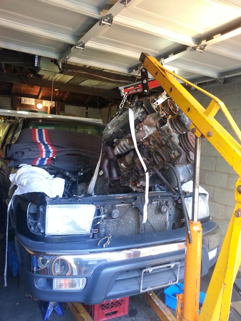

Hook your hoist to engine and start lifting and also lift tranny to the highest point along with engine.
Pull completely out with torque converter and also have a big oil pan cause it's gonna leak.
Remove cross exhaust piece, use flat 6point wrench to break your bolts loose. Do it with a spotter that last bolt out the converter is pretty heavy trying to catch.
Trust me I've done about 5 swaps with this issue. It's a bit messy but the fastest quickest way.

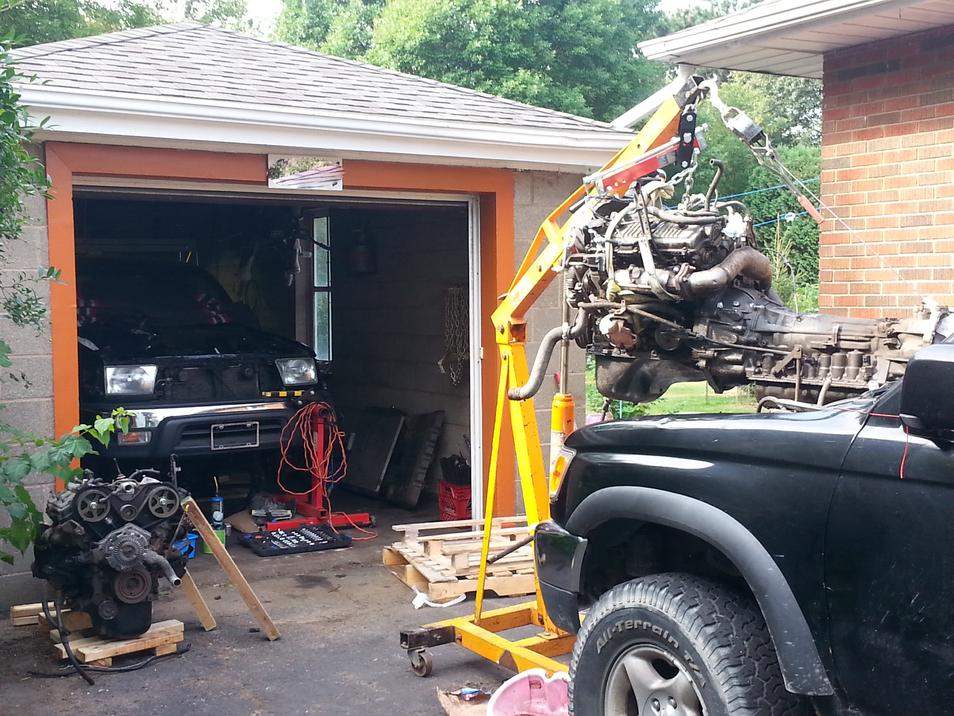

- Pulled Seized 99 Engine with Transmission attached out of the engine bay.
- Pulled Running Engine with transmission attached out of 98 with E-Locker.
- Dropped Running 98 eng/tran into 99 4runner.

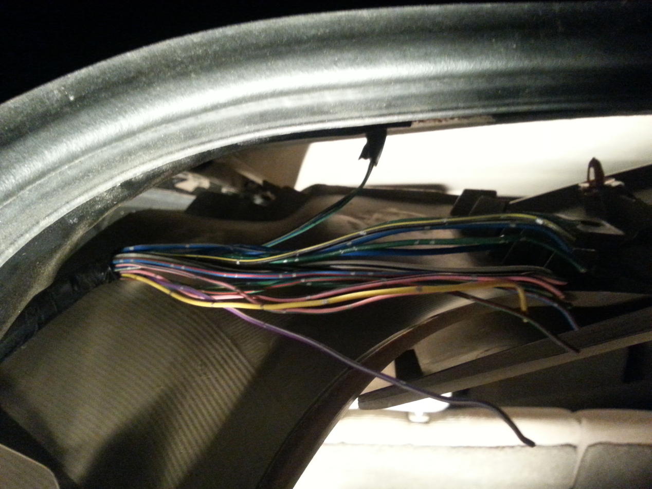

- Trying to rebuild 98 back door and wire up to running 99 that was cut off @ harness.

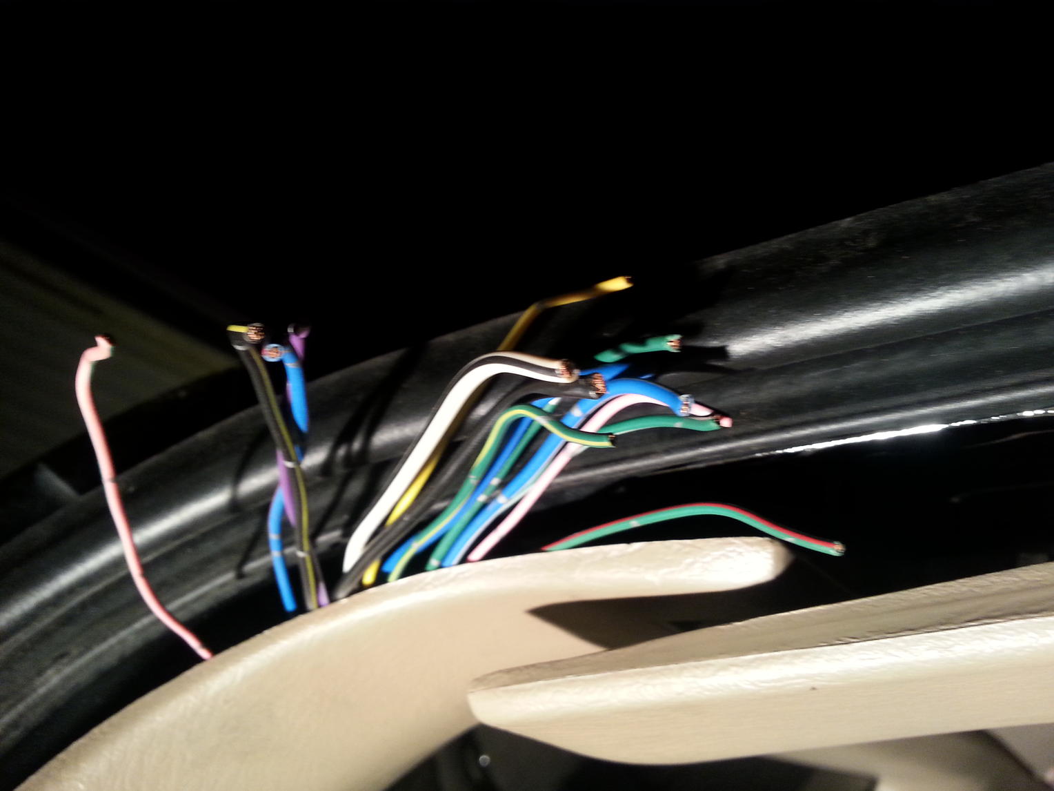

- Whats my best bet for finding out what wires go where? everything's color coded. but nothings matching up. Should i use a multi meter?
- Anyone ever completely rewire one of these backdoor to work?

Wait, you were able to wire up a '98 engine with a butchered harness into a '99 truck with no problems but you are hung up only on the back door? Wow.
This is ctually going to be something of a pain. '99 back door ECU is a lot smarter than the '98 and is married to front Body ECU by a multi plex communication bus for a lot of functions. It's all pretty different from '98, where the Body ECU is replaced by something called an integration relay, and no communication bus.
I really think you need to transplant all the wiring and ECU from the '99 back door into the '98 door shell or you are going to have beaucoup problems. You will never be able to marry them at the junction between the door and the body, if that is what you are thinking, without losing a LOT of functionality.

Thanks for the info. When you say lose functionality, what exactly would i lose?
Wondering if i could i wire it up so that the rear wiper and defog work?
Not to worried about the back window going down. need this one to work for now until i find a 99 rear hatch. seems impossible to find one let alone one to match. Say i cant find one. do you know a good place to find the wiring and ECU for a 99. It would really suck to toss in the towel over the back door. Shes a little dirty in the pics. need to figure out back door before i start building her up. thanks again for any help.

As far as I can tell, there is no Back Door ECU in the '98. There is just a Power Window Relay--almost everything else is wired to the Integration relay in the front, which does not use a multiplex bus.The only things not controlled by the Back Door ECU are:
- the lock motor. You should be able to find a blue-white and a black-yellow in both harnesses and marry those. This will only give you non-wireless function. Wireless will be dead for ALL doors because the wireless receiver is built in to the Back Door ECU on the '99 and there is just no way around that.
-Defrost. Marry two solid black wires and two white-blacks and that should work.
-rear dome light. Marry the red-white from the '98 to the light green-red wire on the '99 and that should work.
You should be able to power the window so that you can work it from the key switch. Connect the solid blue on the '99 to the solid green on the '98. That should give you key control of the window.(plus the white-black marriage above for ground.)
Wireless door function, and washer/wiper all run through the Back Door ECU in the '99 and control is over the multiplex bus. Washer and wiper would only work if you gin up switches to ground from scratch. If you apply ground to the pink wire in the '98 you will get wiper action and ground to the light green wire will give you washer action (assuming you have done the blue to green marriage above for power.). But there is nothing to marry those grounds to in the '99 unless you run wires all the way to the front and connect to the stalk wiring at the panel by driver's knee or just make dash switches to ground. Sorry for the bad news on that. Let me know if you want details on connecting to the stalk and I'll figure that out.
I think these "marriages" will work, but I may have missed something. Let me know what works and what doesn't and I'll look again. Just quote me and I'll come back to this thread.
