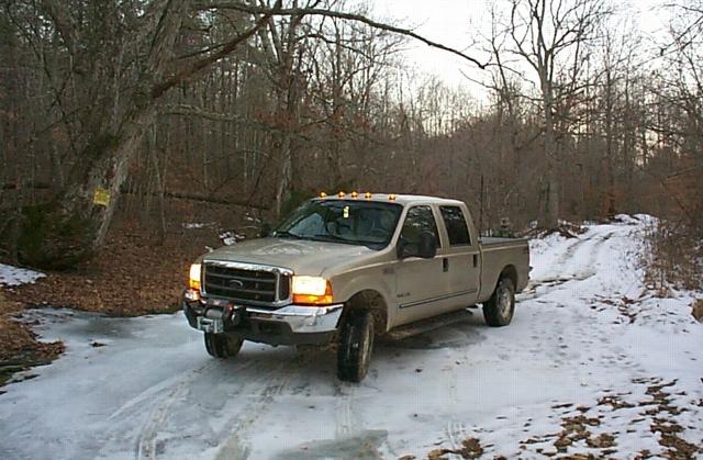

And it might look like this one on Ford:
