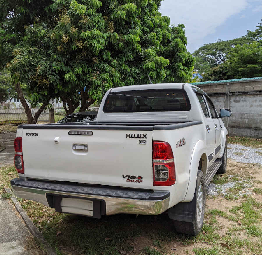

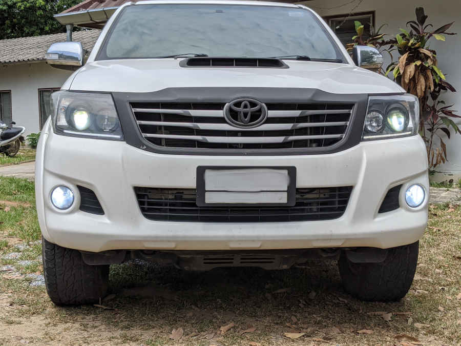

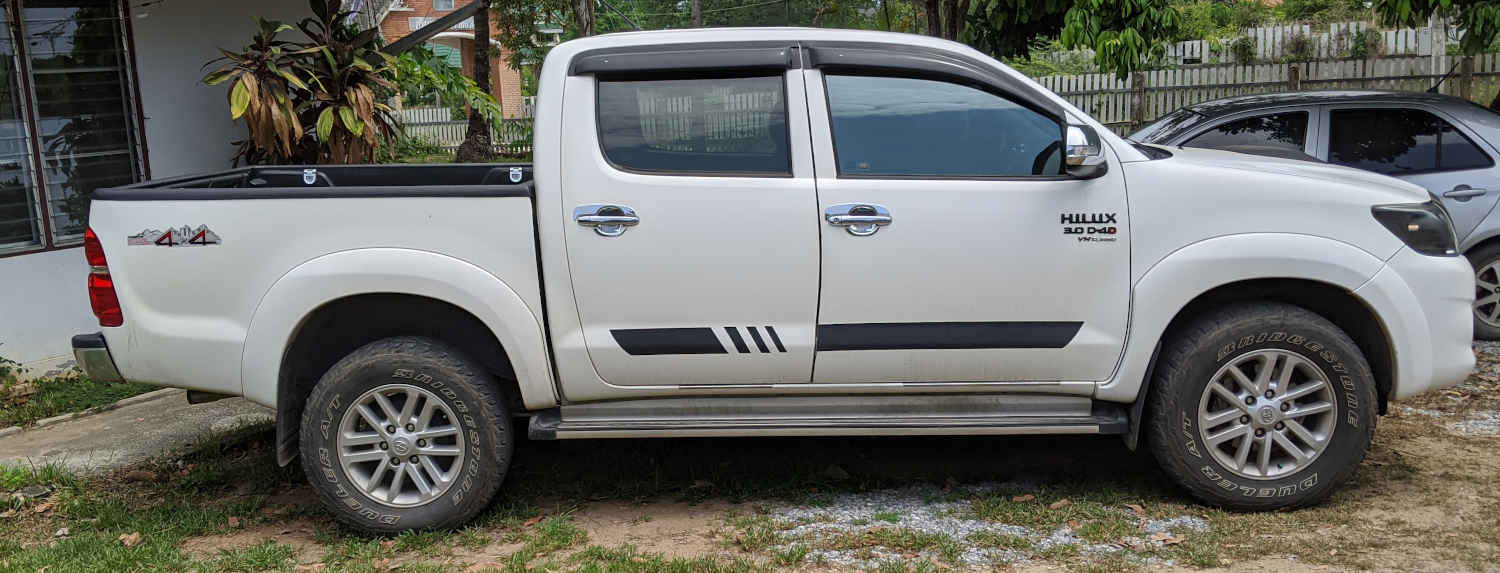

As a side note, I've stayed in the Toyota family: I'm currently rocking arguably the de-facto standard in Toyota Trucks, the Hilux (2014 "Vigo Champ"). And of course, with light mods. Pics!
