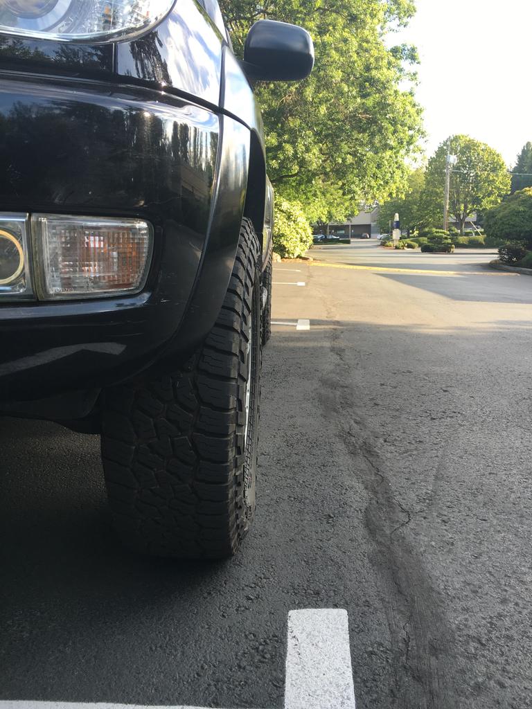

285 and FJ wheels
265/70s: pretty flush imo
285 and FJ wheels
oh yeh! they are pretty flush. awesome! thanks for the pics. i'll prob pick up the wheels next week. there is someone selling 5 with 4 caps and 4 sets of lugs for $365.

Here's a better picture of the poke. Your 275s will have slightly more poke, this picture is the 265/70s again
If the sequoia wheels are 17x7.5+15mm, you'll be fine and clear the UCA w/out issues. Looks like those seqoia wheels are identical to the 5th gen and the FJ wheels. (17"x7.5" +15mm)
sweet! thanks for the pics. that really helps.
