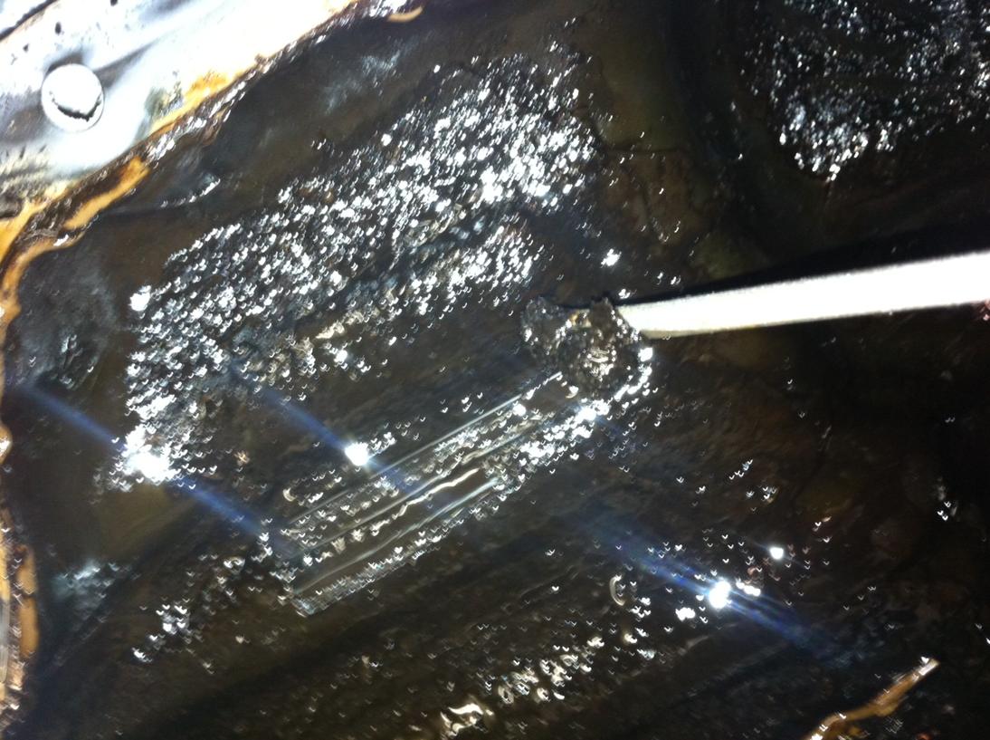

If you are really worried about engine sludge, the 4.7 has a lower small oil pan you can drop and take a look around. I can show you some nasty stuff I found in the 03 I bought. The first 89k it was leased and no records of any oil changes or service. The dealer resold it to another then they put 64k on it. They changed the oil every 4 to 5k. That's when I bought it cheap with low oil pressure and a sludge filled engine and clogged oil pump pickup screen. I also agree an oil change will not increase power enough to feel it.

I would like to see what you found! Other than low oil pressure what are the symptoms of engine sludge?

4.7 engine at idle has only 5 psi oil pressure. Any less than that the oil light turns on.
Here is a picture of the bottom of the oil pan. Other indications can show in the oil fill tube and under the valve cover.

Now that is some sludge! Thanks for posting that.
