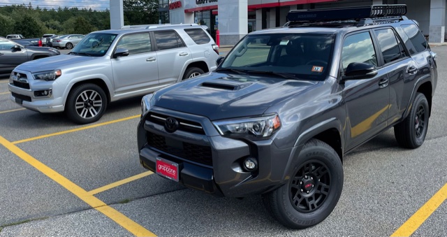

Out with the old and in with the new....
