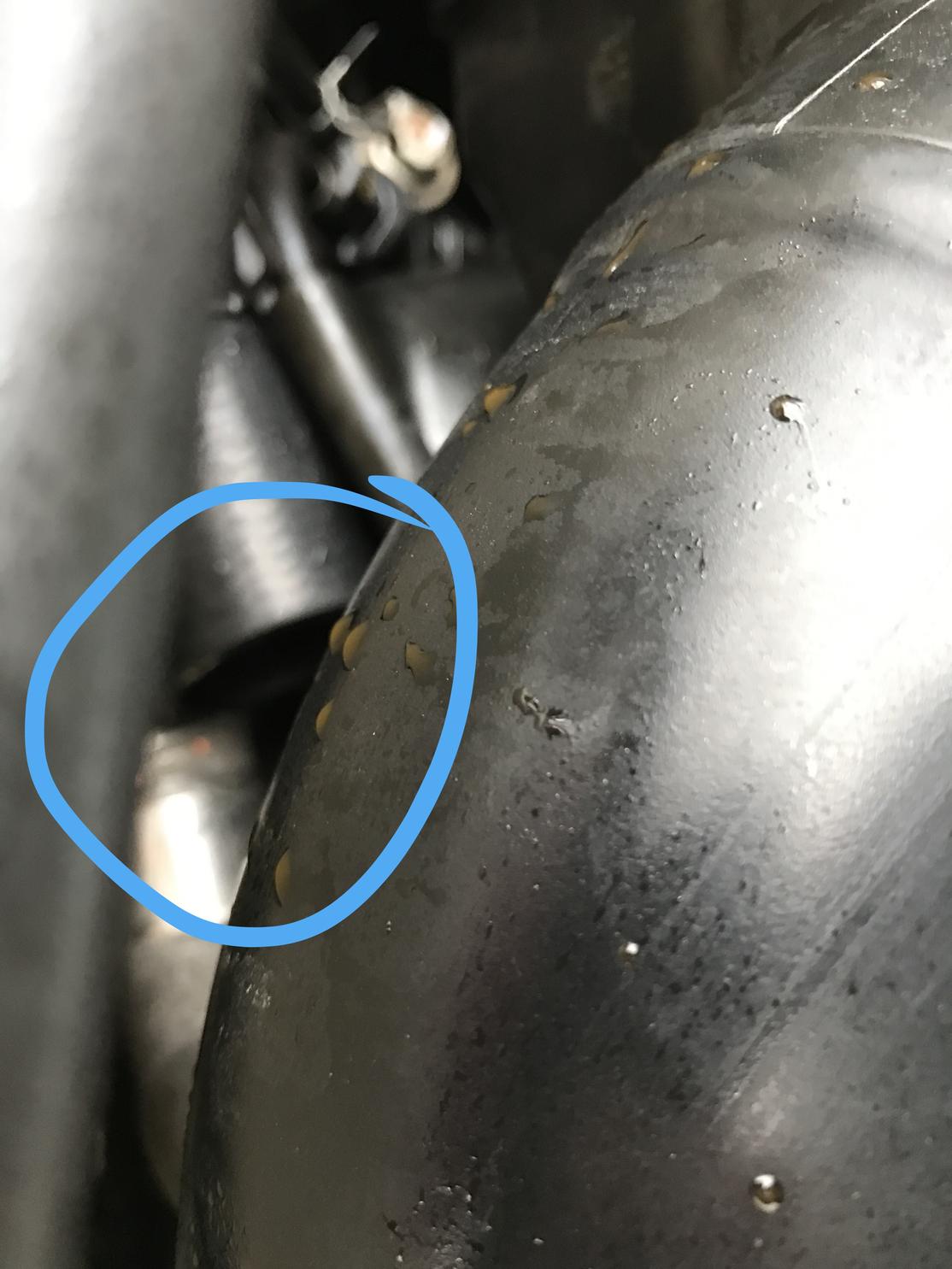

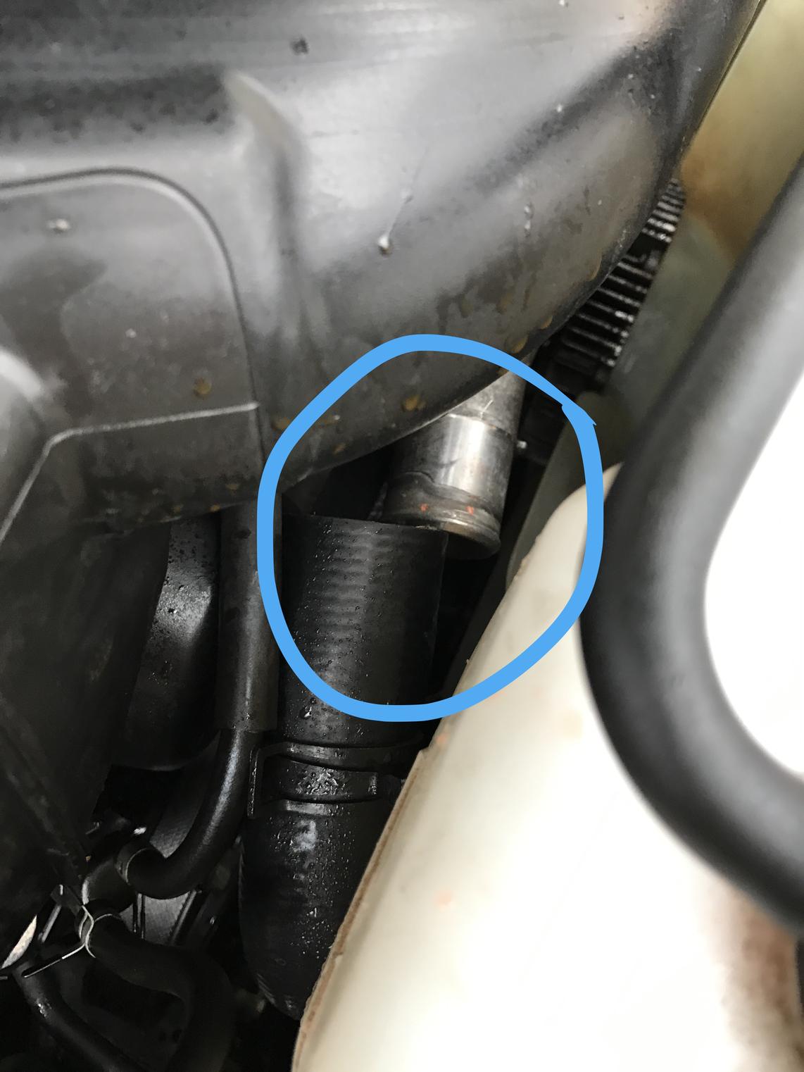

As i am waiting for the tow truck i popped the hood and started digging around. How i missed this last night i dont know..but it appears the upper? radiator hose has become dislodged.
I am still going to send it back to the shop and have them do a once over and correct the issue.
Should i be concerned with the fact that radiator fluid has been sprayed in the engine compartment? Should i attempt to clean any particular engine components off that may be impacted by the fluid on them?

Looks like someone forgot to slide the clamp back up. Quick fix, some wasted coolant and a dirty engine bay but you should be fine with a quick rinse and check over for any other missed clamps or not torqued bolts. It happens.

That hose clamp is not put back where it should be, so the hose worked its way loose. (Being Captain Obvious here!)
Small detail that could have caused major headaches. It already has cased this one.
