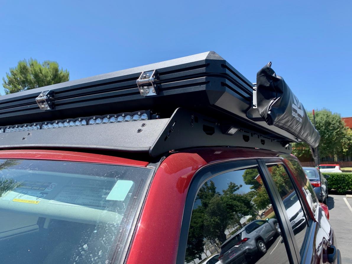

Got many compliments about the rack from Bobby at CVT when they installed my new tent this past weekend.
That's awesome! We are in the process of working with Bobby right now. Excited to see what comes of it. The Mt. Hood looks great!
