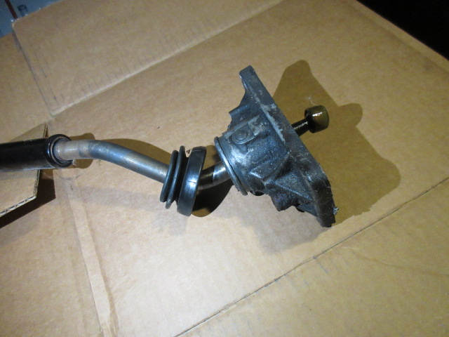

What are you doing? Did you replace the factory boot with another? These are pretty simple. Cant really see your pic, its so small. Here's one I have kicking in the garage, the boot slips over the bevel lip.

I did this same job a while back yes you just drag it down. I put just a bit of grease on the inside of the rubber boot and that helps it slide down.
thanks for the guidance.
was super easy to drag it down the shifter w/ a little grease on it. just for shits/giggles, I took the shifter out just to see how it connected. simple. push the top "shield" down and twist to the left, it pops right out.
