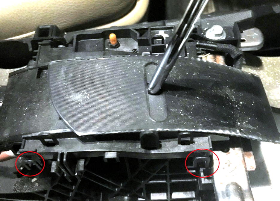

Any tips on removing the gate around the shifter? Where P, D, R, etc. are marked? I can't seem to find anything specifically in the service manual and it's reluctant to come off and I don't want to just keep pulling on it. Have the console out to rearrange some of the cables for my ham radio and the gate is spectacularly dirty - I'd like to pull it to give it a through wash.

I had seen that in the past and have had the console that far apart a couple of times plus now. The part I'm trying to remove is the one piece he dit NOT remove. Right around the shifter.
The plastic piece with the P-R-N-D: on either side, nearest the floor, are two black clips with an upside-down U shape. Look about an inch to the rear of the S-D letters on the side for one of them. The can be released (all four of them) and the piece pulls straight up. Ditto with the clear plastic piece. After that, your on your own...
Pic from passenger side, after removal. Clips circled.
