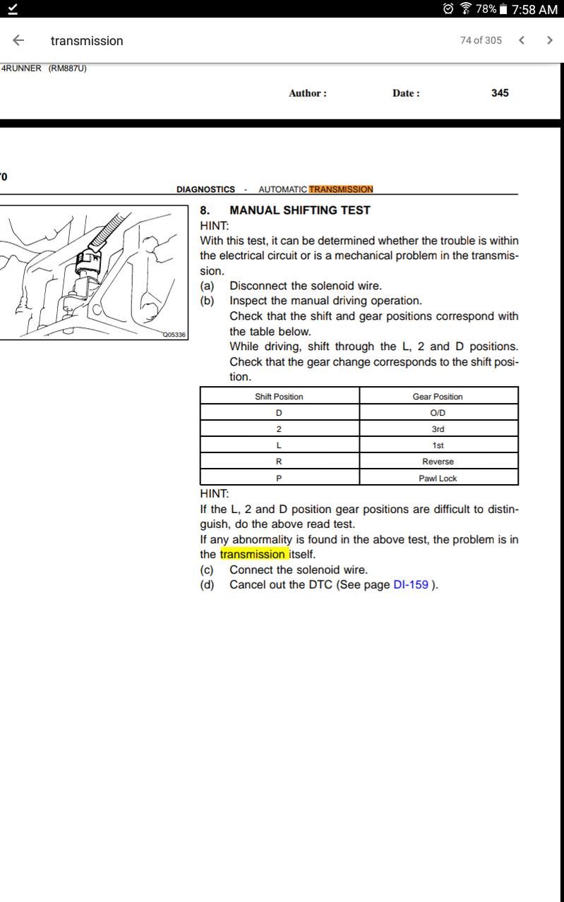

If you disconnect the shift solenoid connector on the outside of the tranny, and try driving it by manually shifting and it still won't shift right, than the tranny itself is probably on its way out. There is a trouble shooting area in the FSM for doing this test.

Although a controversial process but if your transmission is on the way out then a reverse flush wouldnt hurt. but do the fsm manual test first also and talk to a couple of transmission shop for better advice.
