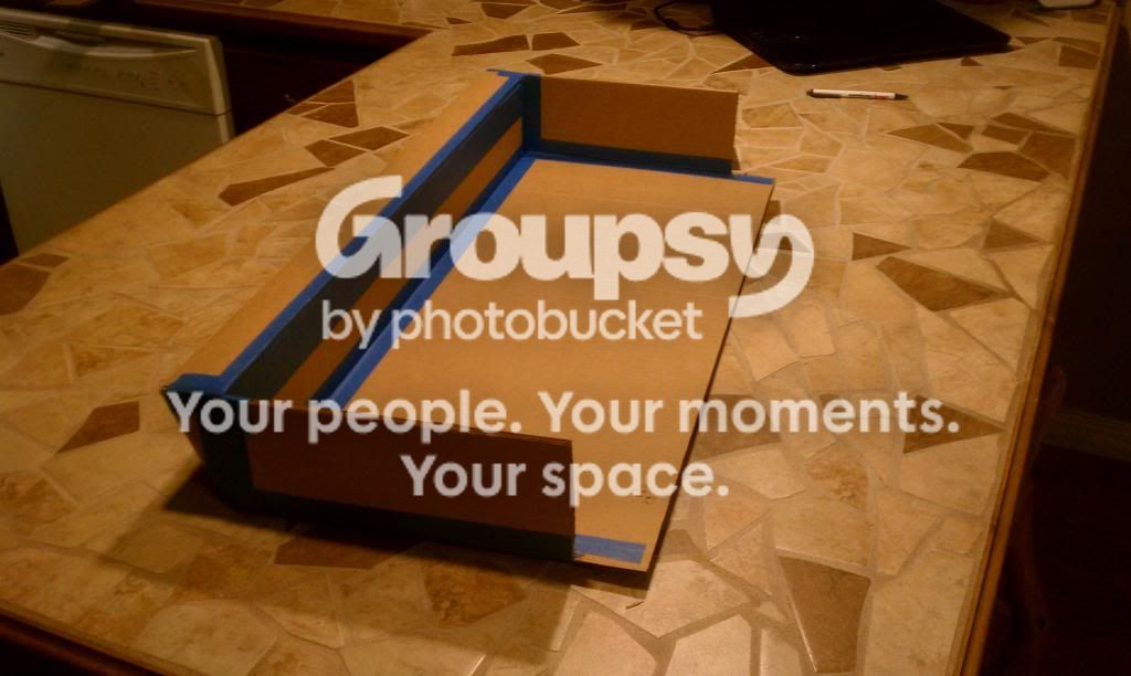

I plan on it. Here's a picture of how I got started. Make a cardboard template for practice and then build off of that. It's early stages in that picture. At this point it looks just like the Savage except for the fact that it's missing the holes on each side.
