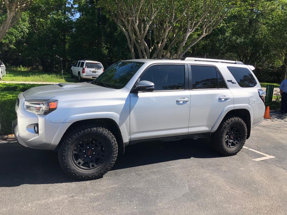

Here is my truck with the Duratracs. Again, they look awesome but I were to tell you that as you sat in my passenger seat going 40 mph you wouldn't be able to hear me. Good luck.
