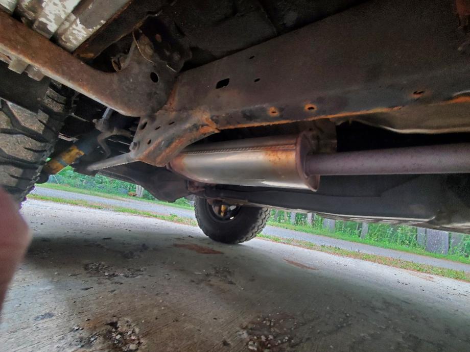

How rusty is it currently?
It's not bad. You can see rust but it's just in the surface. The mechanics are always surprised at how good it looks.

Your rust doesn't look too bad, I wouldn't think it would get worse with one winter with preventative measures. Like the others said above, you may want to sand it down and paint it or use some Fluid Film. :)
