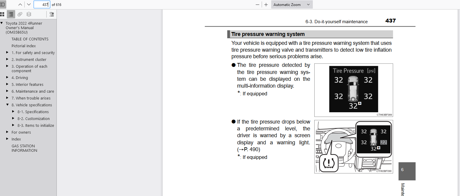

I just looked it up in the manual...it shows the sensor readout with all 5 tires, though the Spare has an asterix saying "If Equipped". Still trying to track that down...
It may also depend if the spare is mounted on a steel wheel. If so, the TPMS sensor may not fit. If your spare wheel matches the other 4 then you might have a chance depending on programming and head unit installed. Seems way over complicated to me!
