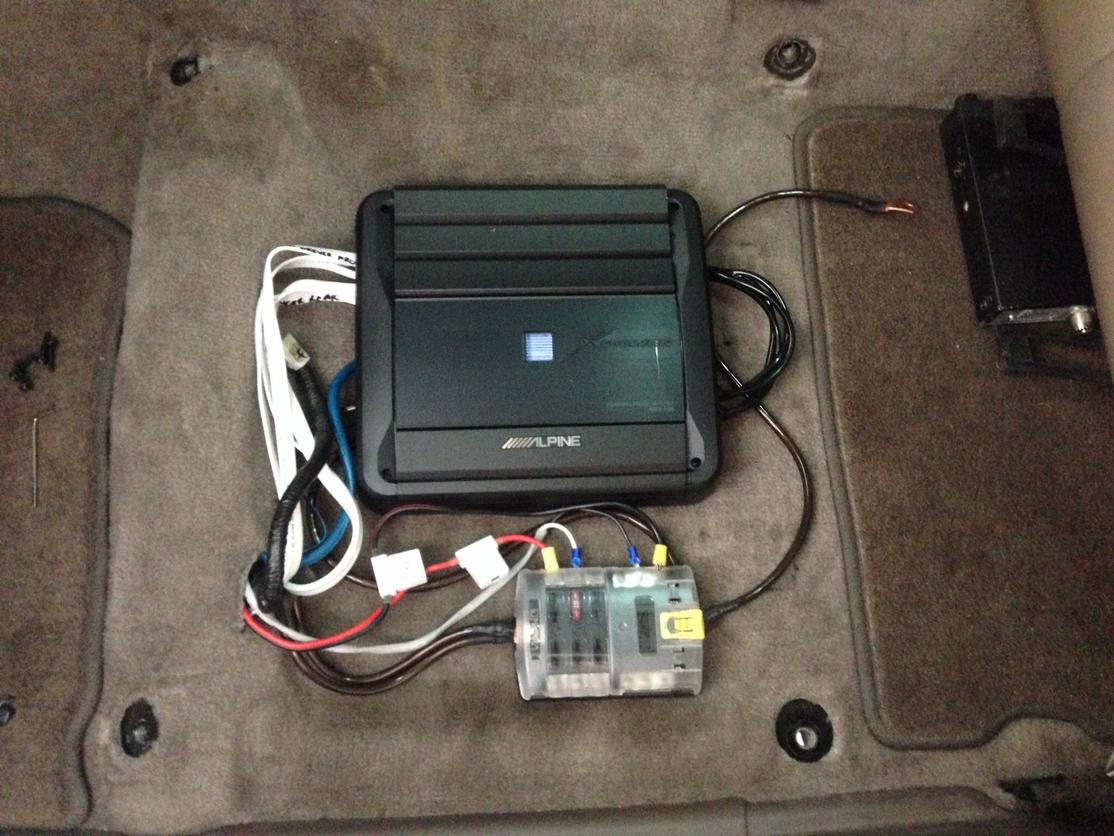

I have a 200 watt speaker amp and a Blue Sea fuse block under the seat. They're screwed to the floor with sheet metal screws and there's plenty of clearance under the power seat.
