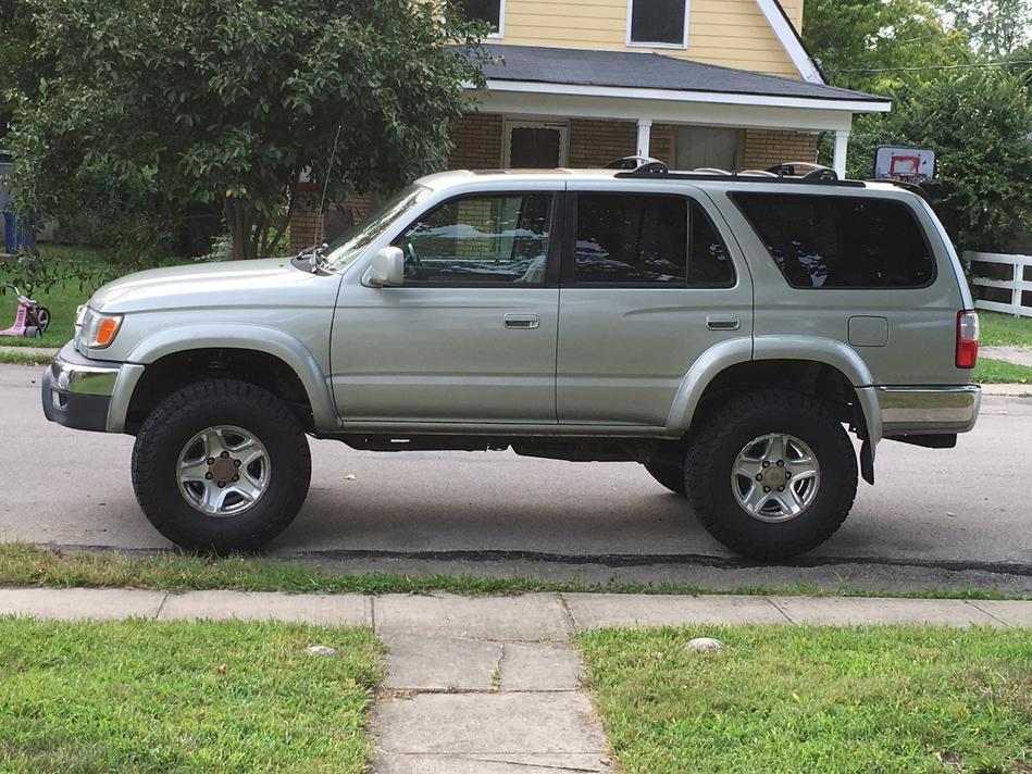

This weekend I installed a 3" Toytec lift with SPC UCAs and Spidertrax wheel spacers and had 285/75R16 BFG KO2s put on yesterday. So far the tires have cleared the rear of the fenders, but the passenger side tire is starting to pull the bumper and flare into the tire. I'll get some pictures of the contact this afternoon when I get home.
Those of you who've trimmed your fat lip bumpers, how did you do it? What would you do differently?

All that to say: this is how I trimmed mine-
Can't tell from the side-
Looks super close, but with the summer small scrub radius of the et0 offset wheels, the tire tucks right in.
I have gone on mild-moderate trails, and the tire will rub slightly in certain situations.
The flare helps a ton in hiding the trimming. The valance is trimmed back 3-4" at the bottom, and angles right up to the bottom corner of the bumper itself.
I used tin snips to trim the plastics, and then a file and sandpaper to make the edges look nice and clean- dare I say factory looking?

Just got home and looked at the UCAs - they actually did change the caster from E to D, shockingly enough. I guess that would have put the tires further away from the front bumper though, so oh well.
I haven't checked the LCA cam bolts, since I didn't want to crawl up under it in my work clothes but I'm going to trim the bumper and flares tomorrow, so I will look then.
