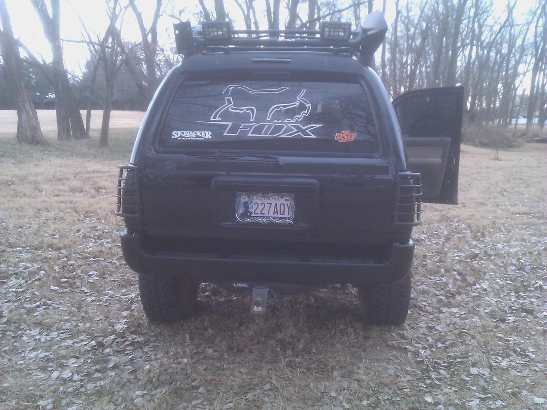

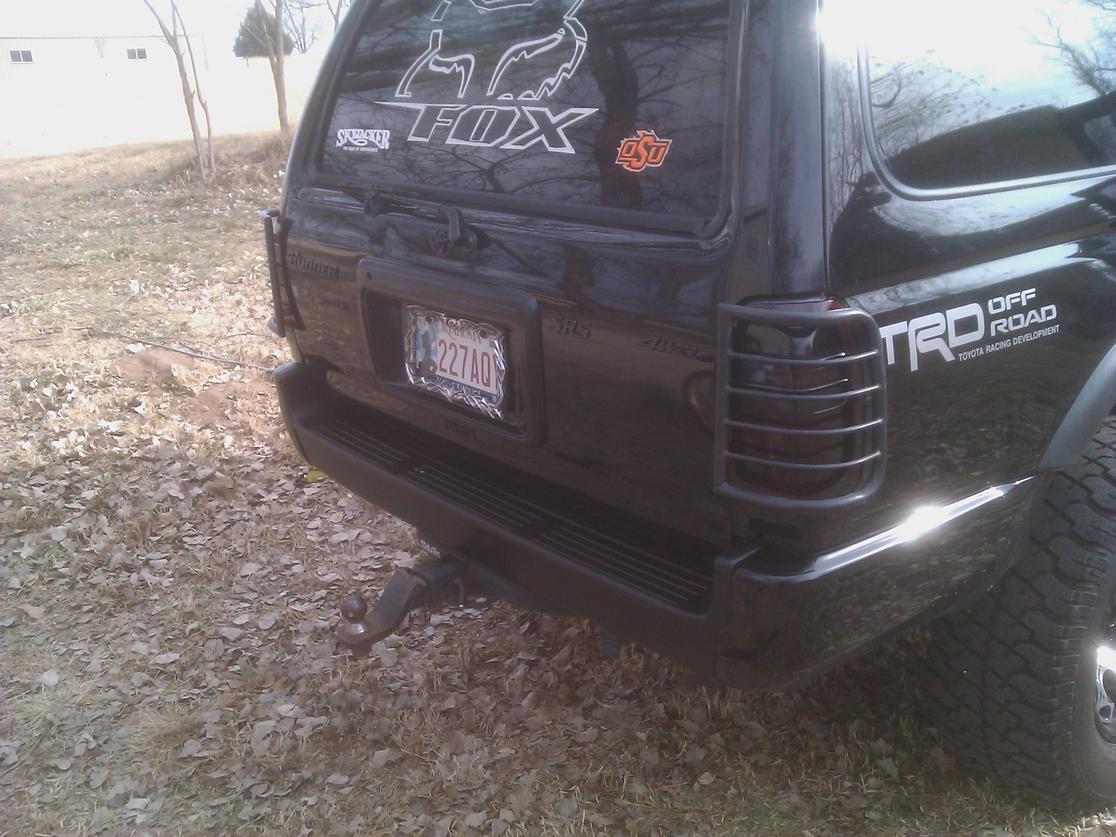

mine are stock 99 lights but i used Night Shade light spray and i think they look good but im going for the all blacked out look, they dont really restrict light and the guards look good.

Hey how did you spray the nightshade on? I just bought some and I'm going to try it out on an extra set of tail lights I have.

1000 grit sandpaper on the lens, wipe away sanding residue. Make sure it's dry.
Do light, even coats of the spray. let dry 10 minutes between coats.
Let dry 45-60mins after final coat after desired darkness is reached.
(will dry to be a little bit darker than final coat, but can be sanded off)
1000 grit sandpaper again, to prep for clear coat. wipe away sanding residue.
same coating process with clear coat spray, except with thicker coats.

Ok sweet. Yeah picked up some night shade, clear coat and 1000 grit sandpaper this morning. All of this is done on the outside of the lens correct? Just want to make sure. :bash:
yup!
And to anyone else reading. Take the lights OFF of your 4runner first.. or atleast mask it off REALLY well.

i masked mine off with no prep but did get my TRD a little with back spray
i would do all the prep but only do 3 coats top, 2 might work
good luck
