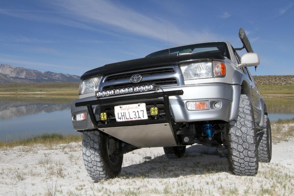

Baja Designs, 20" Onyx Bar and 2 Squadrons with Amber Lenses. By far the brightest LED lights on the market and all built in the US to boot!

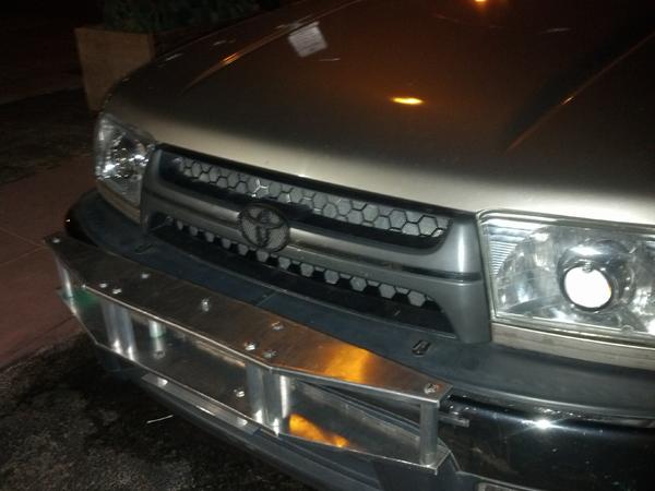

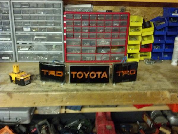

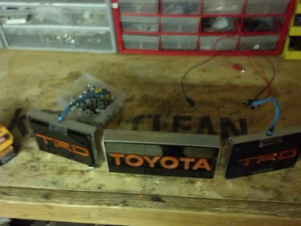

So heres my home made led plate, not much of a bar.

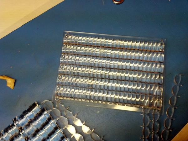

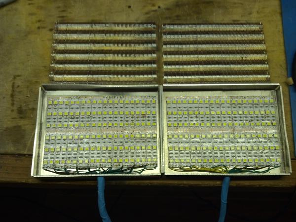

this is the second version, I condensed the leds into boxes that mount into a frame, that i can mount on the front bumper or on the roof rack. I used a brake to cut and bend the boxes and frame out of aluminum, then tig welded them. then i lasercut the lenses out of acrylic lenses, this greatly increased the brightness. btw the whole thing is 100 watts of light, or about 8000 lumens and it cost me about 30 bucks to make. and ive got a 3rd light that goes in the middle that brings the total up to 175 watts and 14000 lumens. they dont project far but the beam width is about 160 degrees, and in combination with my hids it works great. im working on version 3, its going to be a super slim led bar that mounts just above the wind shield but doesnt stick above the roof of the truck.
heres some photos of how i made them too
[spoiler/]

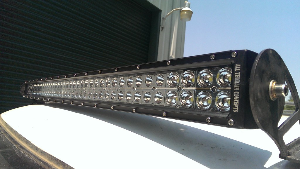

what size and who by?
it would be equivalent to the Hanma that I think Bean sells. These are pre-branding and are direct from China. Given a bigger budget I would definitely go for Baja Designs... better than rigid.
This is a 40" combo, flood on sides and spot in center, doesnt really make a big difference but it might with other brands...
