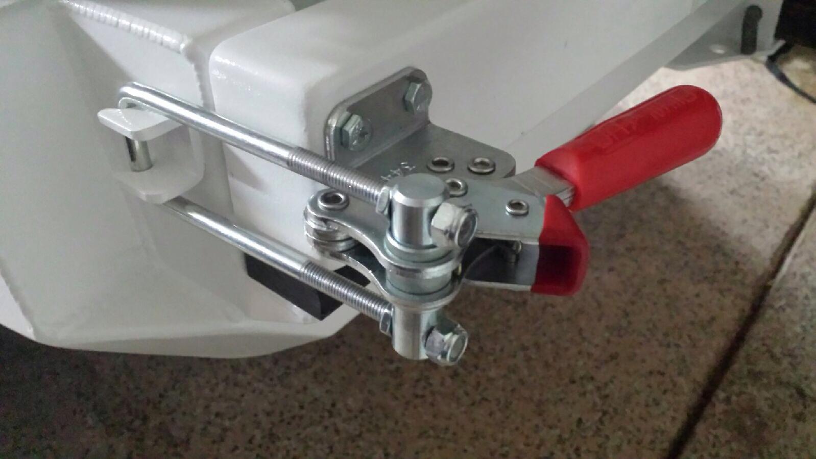

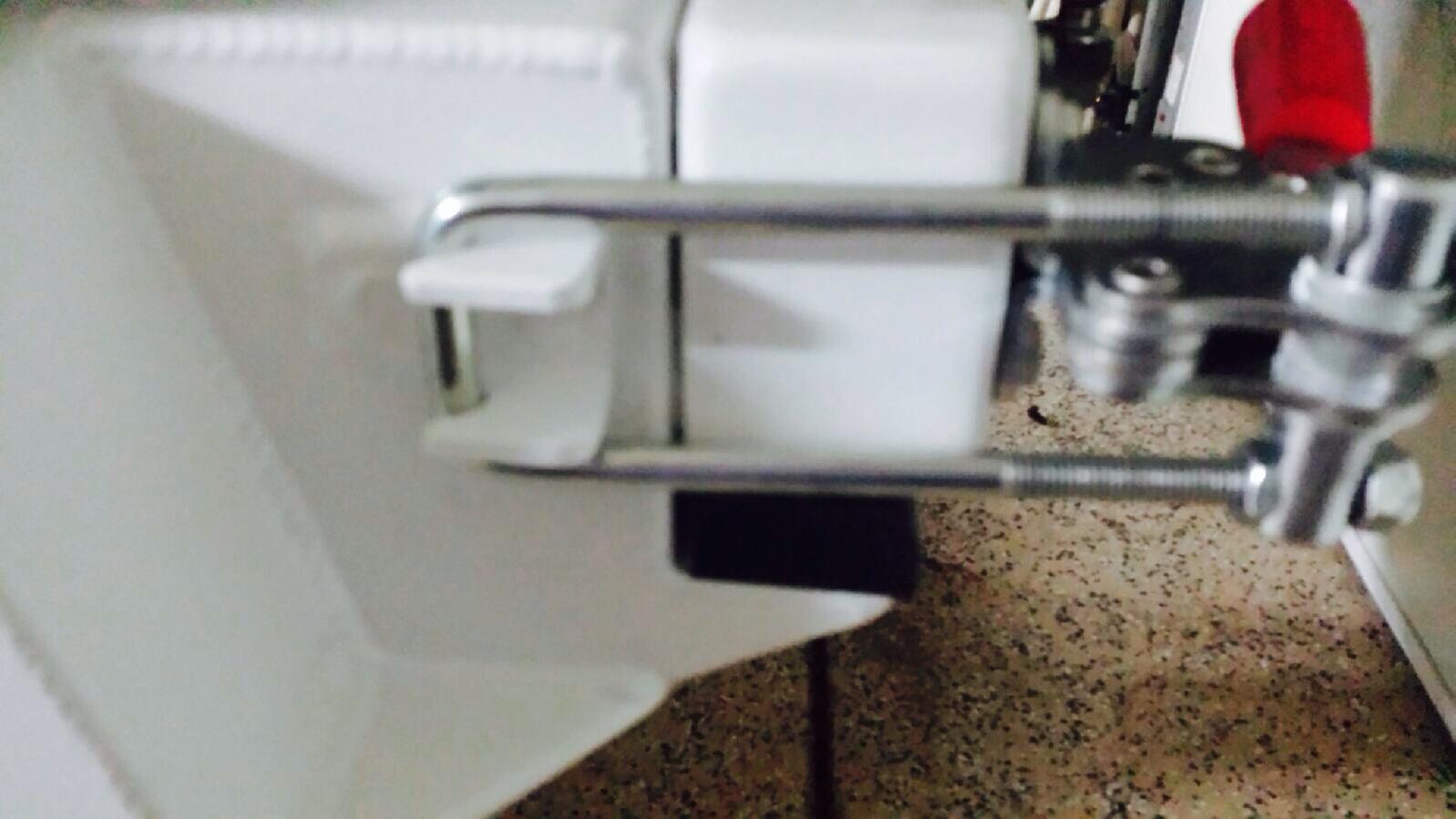

I'm a new owner of a CBI plated swing out bumper. As JWaltz suggested, I opted for a desatco latch based on HungWin build. As far as trail use on the latch, that has not happen yet. I'll post some pictures for your consideration of the latch and locking mount. Hope this helps..... 8sm

We do now offer two styles of latches for those who may have a preference (screw pin style and destaco). There are pros and cons to each in our opinion. Feel free to call us and we can go over your build and discuss the latch that may be more appropriate for you.
