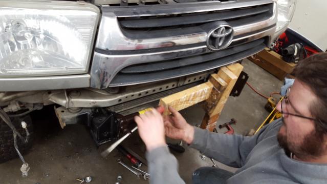

Leave the brackets on the frame & remove the bolts to take the bumper off. I did it last year to sand & re-paint because it was starting to rust after 3 NY winters.
Yes it can be a tight fit. I put a 60 grit sanding disk on my angle grinder & sanded the brackets, the frame, the inside of the bumper, any place that made it difficult to slide the pieces together. But not too loose because you want a solid fit. I also used a 1" chip brush & axle grease on install so it would slide together easily & not scratch the paint off causing rust. I've taken this off & put it together by myself with a floor jack & 3ft 4"x4" pressure treated piece of scrap wood from my deck. It's 89lbs not 200. It definitely helps to have a second set of hands though. I've been on the ground, on my back with both feet in the air holding the bumper in place (along with wood & a floor jack) while tightening the bolts to the bracket! LOL It WAS easier having my GF hold the bumper in place while I tightened! LOL
