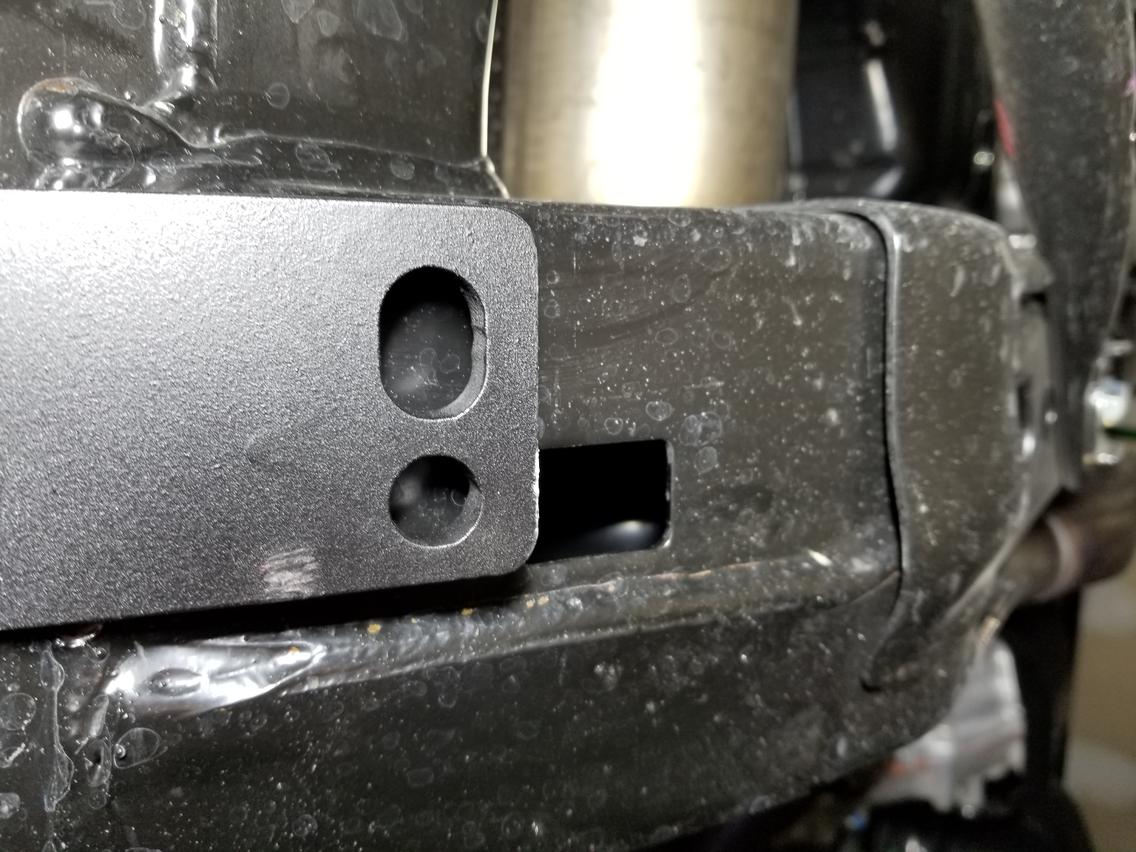

Passenger side is installed and I do have the gap on the bottom front mount. Undecided if I want to drill and fill the gap with washers. Great quality powdercoating though! On to the driver side!
yea same issue on my '18, even with washers to cover the gap wouldnt it just be a pressure point instead of complete support? maybe shrockworks can provide a solution??
That is up for debate, but as long as you have at least one of the two needed on each side, you "should" be ok.
Are you saying One of the two on the bottom? I don't have any holes on the bottom that line up

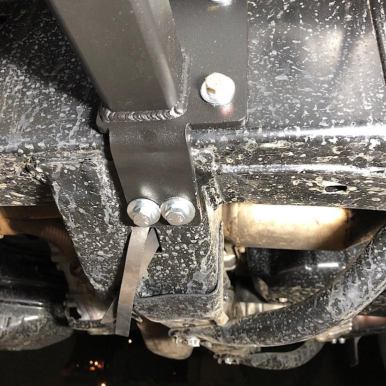

So just finished up this install on a 2018 ORP. Read a few tips and tricks and wanted to quickly list / summarize the ones I found most useful:
1) you’ll need to drill two holes for the passenger front bottom brace... drill both holes, versus 1. Why not? you’re already there.
2) the passenger side had zero pre-threaded options. All bolts required stick nuts. I used 7 of my 10 and started to wonder if I had enough...

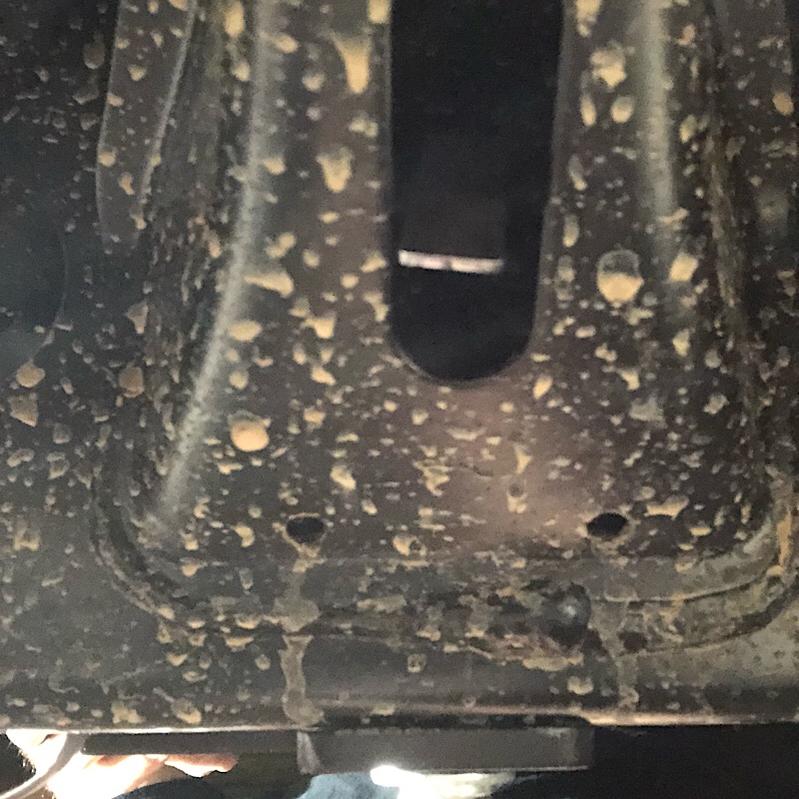

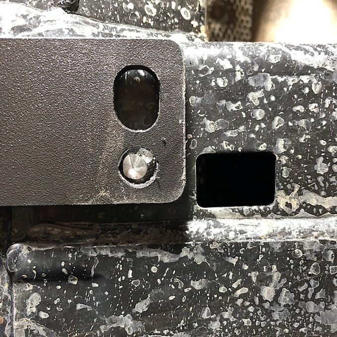

3) took me a LONG time finding a way to get the stick nuts into the rear upper two holes (sts). Turns out there’s a nice opening on the interior of the frame at a bracing point. At first I thought this was a sucker hole but turns out there is an entrance to the inside of the main frame brace. See picture.
4) you will need a table / angle grinder for one stick nut as the 2018 ORP frame doesn’t have a large enough opening for one of the passenger side mount points.
5) use a deep socket and jack to press the gas tank up. I only pressed up on the skid plate but that gave me zero room to remove / reinstall the long gas tank strap bolt.
6) you will need to drill one hole for the driver side front mount area. Total of three holes drilled.
7) I wrapped electrical tape on the KDSS lines, but not enough. You’ll need to wrap a good 4-6” of length since they touch the entire length of the skid bracket. I’d also put a rubber gasket of some sort up there but didn’t have one.
8) I did NOT need a 1/2” longer bolt for the gusset point. It just requires good lighting and turning the stick nut to face the correct direction... oh and a strong motivation to FINISH without another trip to the hardware store.
9) all my stick nuts were already rusted when they arrived. So have a de-rust plan and spray paint early.
