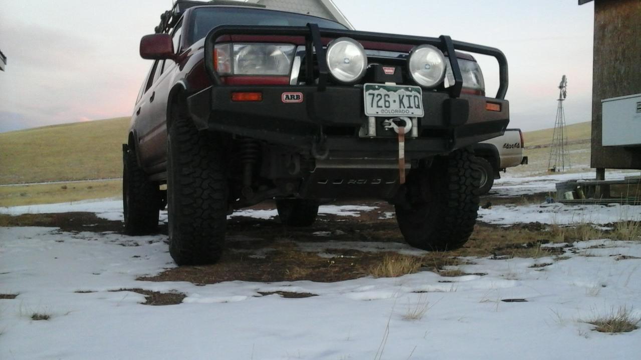

I have them, but I got them used on a good deal. The front/radiator portion does interfere with the ARB bumper you have - do a search to see what's what I mean. It bolts to the tow hook mounts in the front:

You probably don't need the transfer case skid if you have 2WD. I'm happy with their front, engine, and tranny skid but their transfer case skid won't work right on my 2000 with multimode transfer case. As was previously stated, you'll have to modify the front skid if you have an ARB bumper (which I do).

The shrockworks are pretty solid with the front mounts going to the tow hook location, but they can interfere with a lot of aftermarket bumpers. Mine hits my Addicted Off Road cross member so I had to space it downward a little bit, or you can cut the top of the skid plate off. I had an issue with the transfer case hitting the transfer case skid and causing a clunk. I fixed this by spacing the skids down with some 1/8" Aluminum bar stock.

The RCI works well with the ARB . Available in steel or aluminum too. 20161209_164729.jpg
