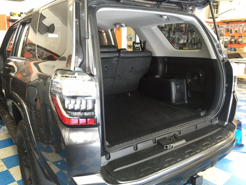

I have the tacotunes sub enclosure. If you're ok with the downsides it has (because of size) then it really is a good product.
I shopped around and one of the better reputation audio shops quoted me 900 dollars just for the fiberglass enclosure. That was what led me to purchasing the entire TT setup for my 5th gen.
Things to note:
- You can't recline the back seat that is directly behind the enclosure. In my standard SR5 4x4 that means 1/3 seats in the back. The other 2/3 can still recline all the way
- The mounts for things like the rago modular racks and the cargo net/cargo cover are taken up by the enclosure's mounts so you cant use those either.
Other than that though I am really pleased with the setup.

I’m planning on purchasing this sub enclosure. Do you have to drill your own mounting holes for the sub, or does it have anchor locations for mounting screws?

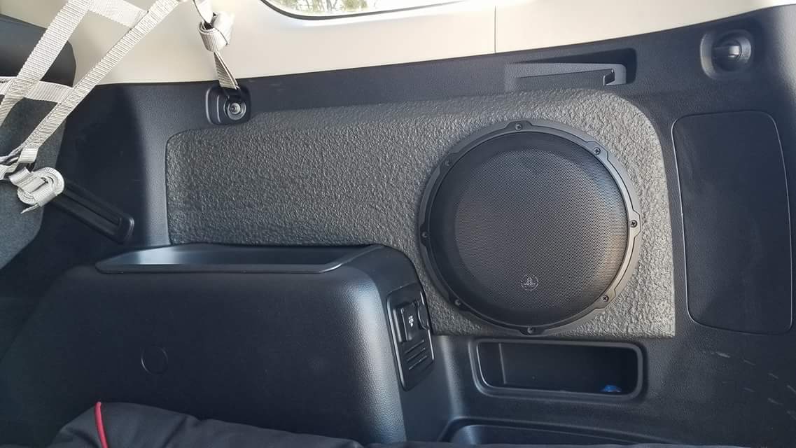

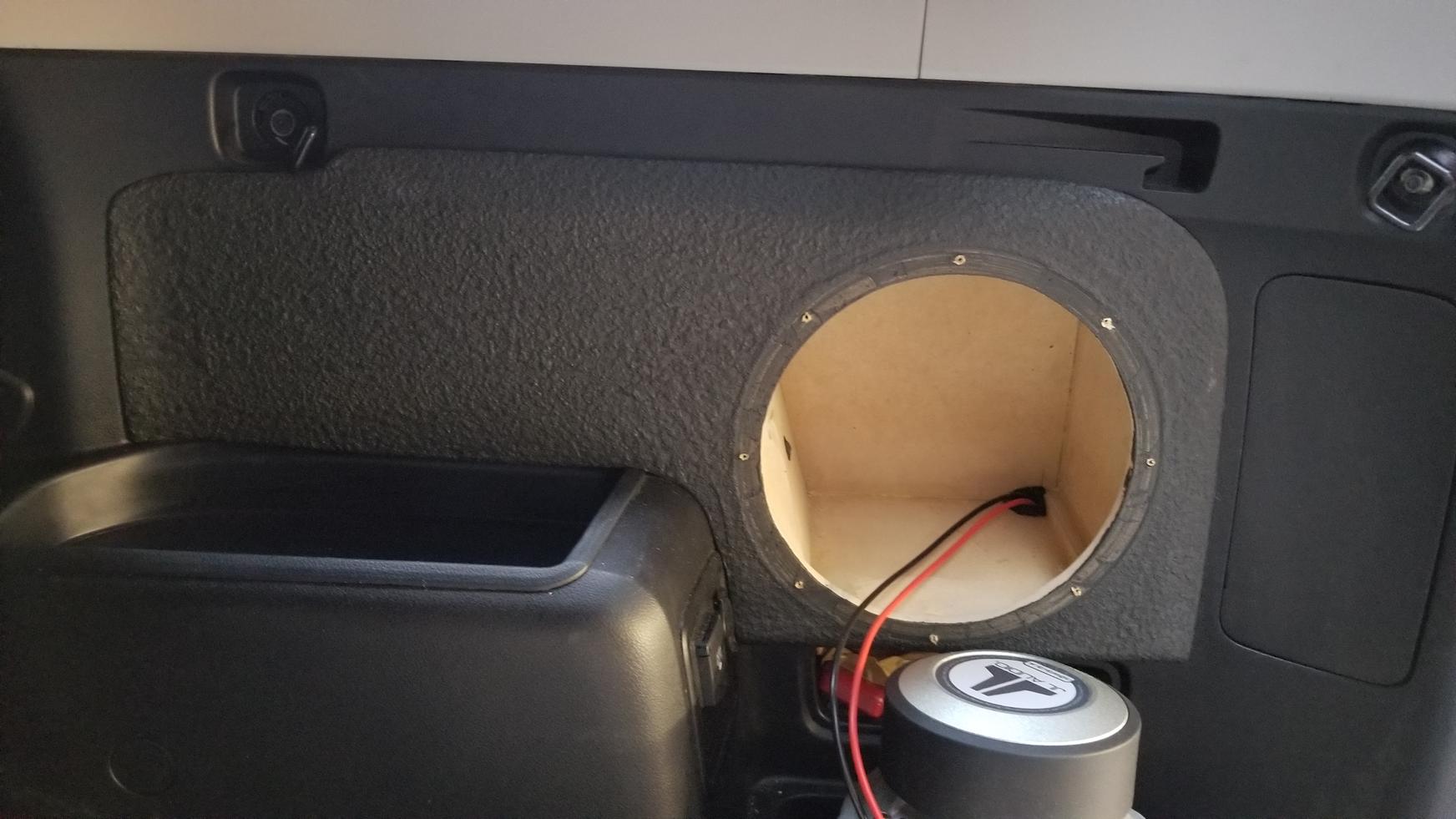

Pull out the panel is best and safest. Just made some simple "L" brackets to anchor solid and cut trim panel exactly so it is a tight fit. Yes, the panel is "permanently" modified but no rattles and solid as hell. It's staying there forever just as if it came that way in ours.
The shops will not be cheap on this, probably $500 or up depending on the area just for the labor.
NOTE: I ran high end car audio shops for years so this was a no fear approach for me but your results may vary.:jk:

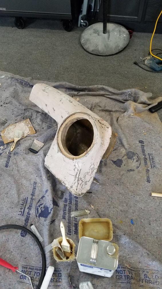

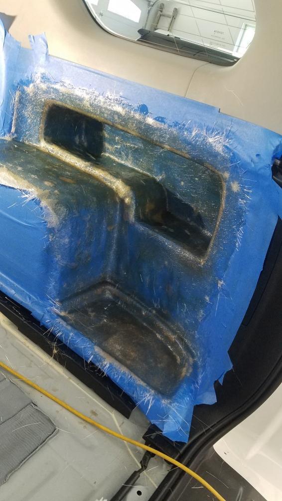

I just made mine myself out of fiberglass. The audio shop prices are so high due to the labor/time. Honestly, if you have space and time, its pretty easy to make one yourself for a FRACTION of the price. I think I spent ~$100. It's not perfectly shaped as I am decades out of practice but it holds a 1000w Alpine R just fine!
I have a write up done on my "Globetrotter78 Build" thread ( I don't know how to link it here).

Man, that is beautifully done!!!! I am envious of the skill here. I am pleased with how mine came out but I definitely would do a few things differently. Don't laugh too much at my amateur hour work by comparison. LOL :thumb3:

It had the holes and stuff already done. All I had to do was screw the bolts and washers in

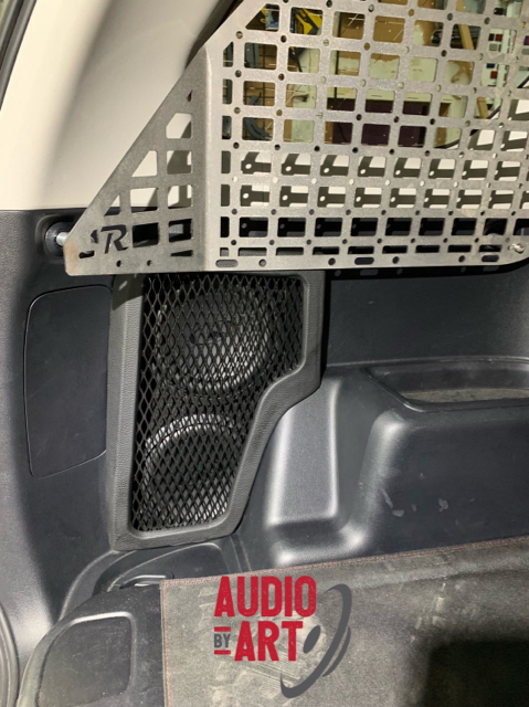

Here’s another way to go that doesn’t use trunk space. I had this one custom done by a shop since all the other options used too much storage room for me. Used the space where the bottle jack goes. Two 8” full size woofers.

what subwoofer are you using?
