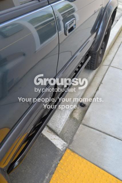

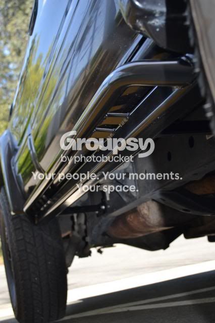

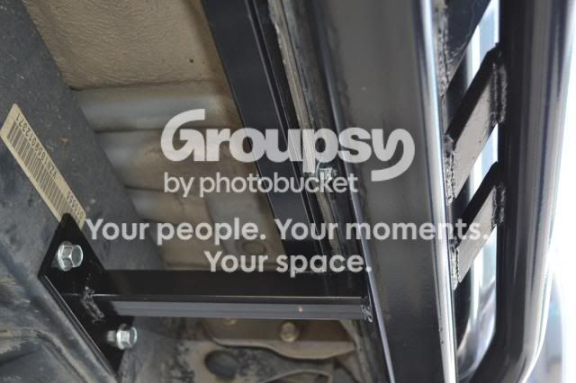

I bought some rocky road outfitters super sliders. I heard some mixed reviews about them. I had them in 2 weeks from the time I ordered and had no problems. I really like the design and finish on them. They don’t stick out much which I also like. I am not really a fan of how they’re mounted and may switch to a weld on. They have 2 kicks that mount to the frame and 7 bolts that go through the body. Here are some pictures that give a better idea.
DSC_0137_zps60b26a8a.jpg~original
DSC_0138_zpsd0c8a8e3.jpg~original
A good image of how they’re held on. I’m a little concerned that if I slip and land on a rock this won’t hold up well from the force. Though they may distribute the weight better than I am envisioning. Like I said I may switch them out for something else.

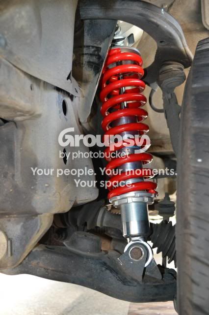

I received the lift I ordered from Toytec on Thursday and over the weekend of the 23/24 I was able to get it installed myself. It was the first time that I had done a lift or any kind of suspension for that matter. I took my time and made sure it was done right and I really didn’t run into any problems like I thought I would.
Parts installed were:
Front Bilstein 5100 with 600 lb coils
Rear Bilstein 5125 and OME 890 coils
Getting the front out was easy. My struts came pre-assembled so I did not have to worry about using a spring compressor. Didn’t really want to go through the trouble.

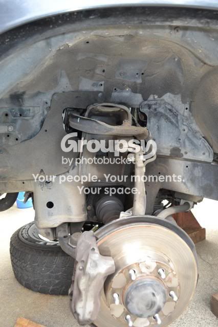

Getting the lower bolt in place was difficult at first. I used a long pry bar to get some leverage and managed to get it in place relatively easy after that.
DSC_0177_zps564d3743.jpg~original

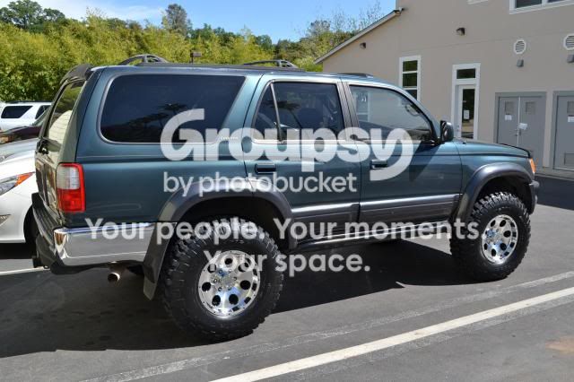

Well it didn’t take more than a week for me to decide that I didn’t like the 265’s with the lift. I decided I wanted some new shoes. I decided on BFG KM2’s and wanted a 33” tire. I went with the 255/85/16. I also had to switch rims as the stock rims didn’t have the right backspacing. New rims are MB Razors. The stock rims caused the 255's to rubbed on the frame very bad.
New rims and tires:
DSC_0173_zpsa1b6acb1.jpg~original
I haven't had a chance to take her out yet. I'm hoping to this weekend.

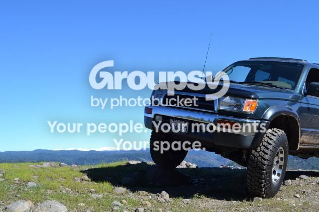

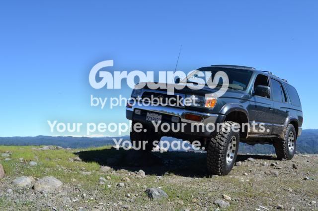

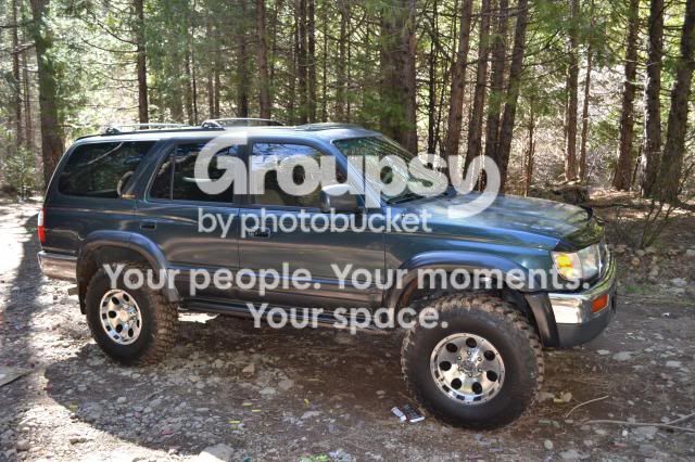

Took some time and ran up the hill to do a little shooting after work today. First time out since I lifted her and put new tires on. Here are some poser shots.
DSC_0306_zpsdbe6dba6.jpg~original
DSC_0310_zps9abc66df.jpg~original
DSC_0315_zps97016fe7.jpg~original
DSC_0313_zps413c5eb7.jpg~original
Can't wait to really do some wheeling with the new setup.
