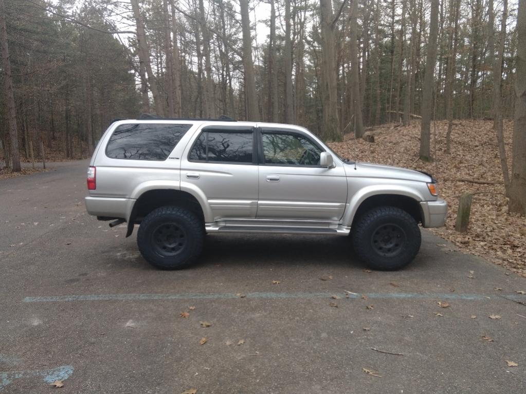

Most recently (Thanksgiving week) I finally got around to installing the SS 1.2 system that had been sitting in the box for almost a year. During the install I also did a complete front end refresh that consisted of new LBJs, UBJs, LCAs, OTREs, and an OEM steering rack. Replaced the UCA bushings and rebooted/rebuilt the axles while I was at it too. Put some fresh General Grabber ATX 265/75-16's on after the suspension work was completed. Everything sans the kit is still OEM. Steve from Sonoran Steel wasn't lying...it rides like a Cadillac!

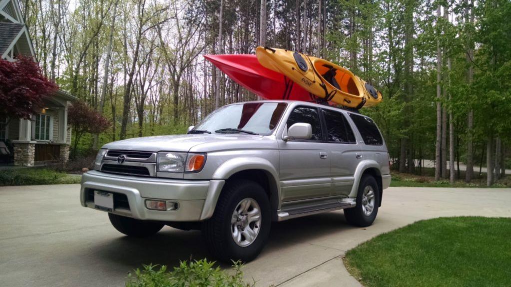

She's a daily driver that is mostly used for overland/camping/kayak trips. Don't hate on the steps as they are very useful for loading the kayaks and can be removed if need be. Some sliders are on the wish list though.

Here's how it sits as of today with 177k:
