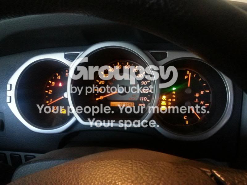

I fired up my 2005 T4R today, and all these lights went off! I read some threads on this in other forums (didn't see any here) and it seems like the GAS CAP can cause all this chaos with your skid control!
Not sure what the Japanese engineers were smoking when they tied the gas cap sensor to the VSC lights, the skid light AND THE check engine light. Had I not researched it, I would have been rushing to my local stealership and forking over good money for them to diagnose. Crazy.
So I went out to the 4Runner after researching and sure enough, the gas cap comes off WAY to easily. It will snap several times like I'm tightening it, but it does not actually tighten up. It just slips off as if I had set it on the filler hole.
Just ordered an OE Stant cap from Rockauto for $8.49. Will let ya'll know if that does not work.
Here's the chaos of lights.....
Well, I already ordered the Stant OE. I guess if it doesn't work, I'll return it and get a toyota one (at four times the cost).

For those that have replaced the gas cap because of this issue...are your lights coming on and staying on no matter what, or do they come on while driving and are then off when you start the car back up?
These lights come on in my wifes 2006 Sport, while driving, and then are off when the car is turned off and started back up.

That being said, I had an issue where my gas cap was tight and clicked, but actually loosened up by itself over time. I ended up getting a Toyota gas cap for about $24, this was AFTER I had already confirmed that the DTC I was getting was in fact a P0455 and that the EVAP system was not having any issues.
