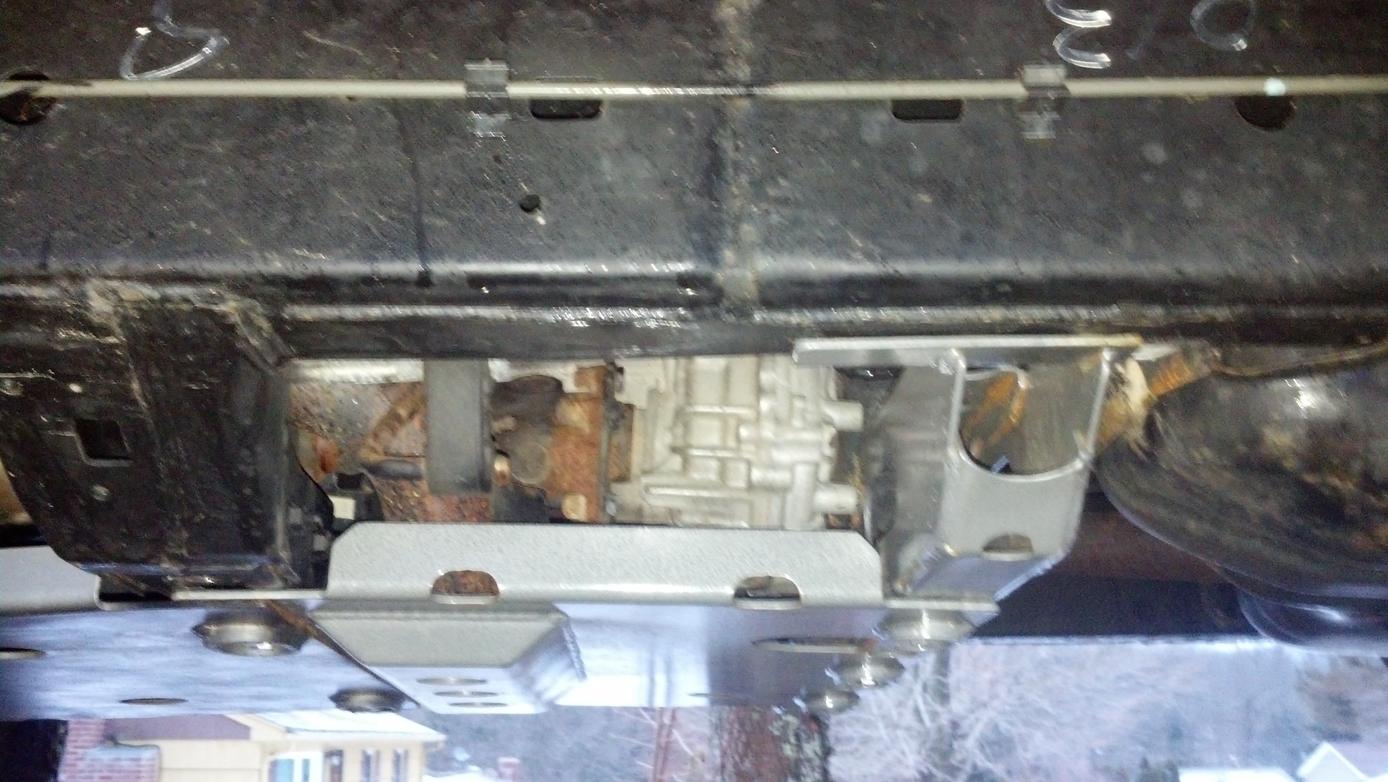

Thanks for the pics, jd... though it looks like you may be the bringer of bad news. Unless I'm mistaken, one of the U-mounts slides under the exact same brake line bracket as the skid plate cross brace.
Let me take a photo for you later today of where my cross brace bolts to frame relative to the slider mount. I've got them both. Although the cross brace had some minor fitment issues, it was not due to the sliders. (That said, if you're doing both, I recommend mounting cross brace prior to installing sliders.)

I have the 4plus skids,good choice, I will take a pic later for you. The cross member goes directly undre the transfer case, not behind it, si if you look under the truck and find the t case you will know where the member bolts to the frame.
I did have to do some cutting, grinding to fit the cross member in there, I'm pretty sure they use the FJ peice for the runners, It wasnt too bad but I would have skipped the powdercoat at least on the crossmember if I had known I ws going to hack it up.

Sorry it took so long to get a pic. The man a fre cross member is on the inside of frame only, this is where it sits. 2013-02-20_06-48-01_912.jpg
