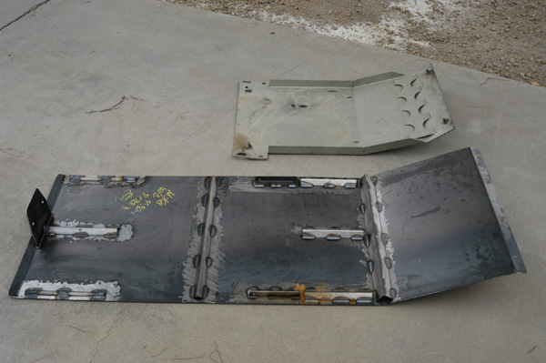

Could you measure your skid plate and post the dimensions? I'd appreciate if you would do this, because it may really help me with making it myself. As far as I got you right you had a small skid (Downey) and now have big one (AZrain).
I could but since this skid was originally designed by Mike (AZrain), I can't w/o his permission. Just trying to protect his intellectual property. I hope you understand.
But here's some quick facts on it. That tab on the end that sticks up goes right after the cross member behind the tranny so that should give you some pretty good measurements right away. You can easily just get a ruler and measure the entire bottom and fabricate something from cardboard and have someone make it off of your cardboard design. This is what I did when I was building my rear bumper (built a cardboard mock up before working on the raw steel).
You can use your stock skids to get a pretty idea of where you want to mount in the front along w/ the angle of the skid itself too.
Time to get down and get dirty!
Good luck!

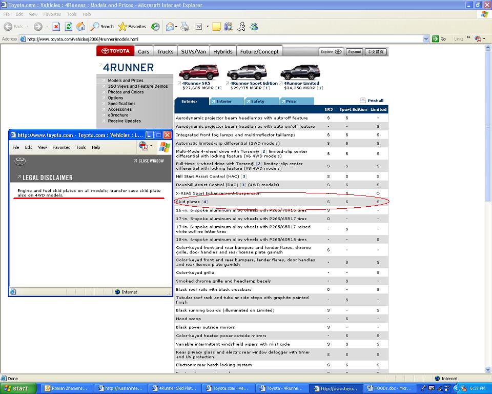

I looked in Toyota website and found that 4x4 '06 have engine, transfer case and fuel tank skid plate on all models.
2006 model owners! Could you make some images of your skid plates and post them?

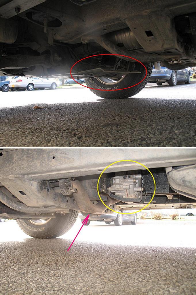

Does anyone know what this skid piece for (1st image) is? I can't call it skid plate because it doesn't have any fixing point at the rear end.
When I was inspecting my underbody I found that one of the exhaust pipes is oval in shape (Shown with arrow on 2nd image). Is it suppose to be like this or I hit with a rock? I checked the Toyota website and it says that 4Runner has engine, transfer case and tank skid plates. I can see engine one, but where is transfer skid plate (yellow circle)???
1. (Red Circle) That's the rubber (I think it's rubber) piece of the skid
2. (Pink Arrow) Exhaust is fine it's suppose to look like that as it just sits really really low
3. (Yellow Circle) That's the Transfer Case Skid
I totally forgot that you had the v6. The problem you'll experience is that for the v8 model my skids end right where that pink arrow is located. The exhaust is not located there nor is the transfer case sitting that low. My tc actually sits a lot higher compared to yours.
Since I haven't really looked at a v6 model in awhile I completely forgot what it looks like. I guess making a decent skid for the v6 model will be more of a challenge since I don't see any other cross member after the transfer case. It'll be an interesting challenge indeed and I hope Budbuilt is looking into this as I never thought about a skid that required 2 diff versions for 2 engines.
Since the taco is only v6 and if they're building one of the taco I'm sure they know alraedy though.
Good luck
I totally forgot that you had the v6. The problem you'll experience is that for the v8 model my skids end right where that pink arrow is located. The exhaust is not located there nor is the transfer case sitting that low. My tc actually sits a lot higher compared to yours....
1. :confused: rubber piece. What for?
2. Oh,... I was worrying that I bend it.
3. Those small metal shits are the skid plate? I definitely need something better!
Yes I've V6. I'll make some images behind transfer case and will post them tonight. Are you sure there is nothing behind it? I do not remeber what I have there.
