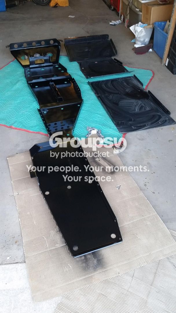

I will take a couple of pictures in the moring to show you where I cut them. Here is a pic of the buds next to the shockworks.
As you can see the buds protect more area but most are non essential. Only two essential (imo) that the bud cover and the shockworks don't are the lca bushing area and the cat. I think the bud built covered 40% of the cat deturing theft. The shockworks left the lca bushing area basically exposed. The shockworks skids (not including thr gas skid) weighs ~12 lbs less then the buds combo (front and belly) which is another reason I like them over the buds. Ok, I don't go rock crawling that often, in fact I hardly at all but the shockwork skids do have better mounts then the buds. The bud builts use the front radiator cross-member and also mount to the steering rack. Not great mounting areas for rack bashing. Shockworks mount drectly to the frame for the most part. In fact they use the same mount as the arb bumper mounts. Pictures tomorrow :)

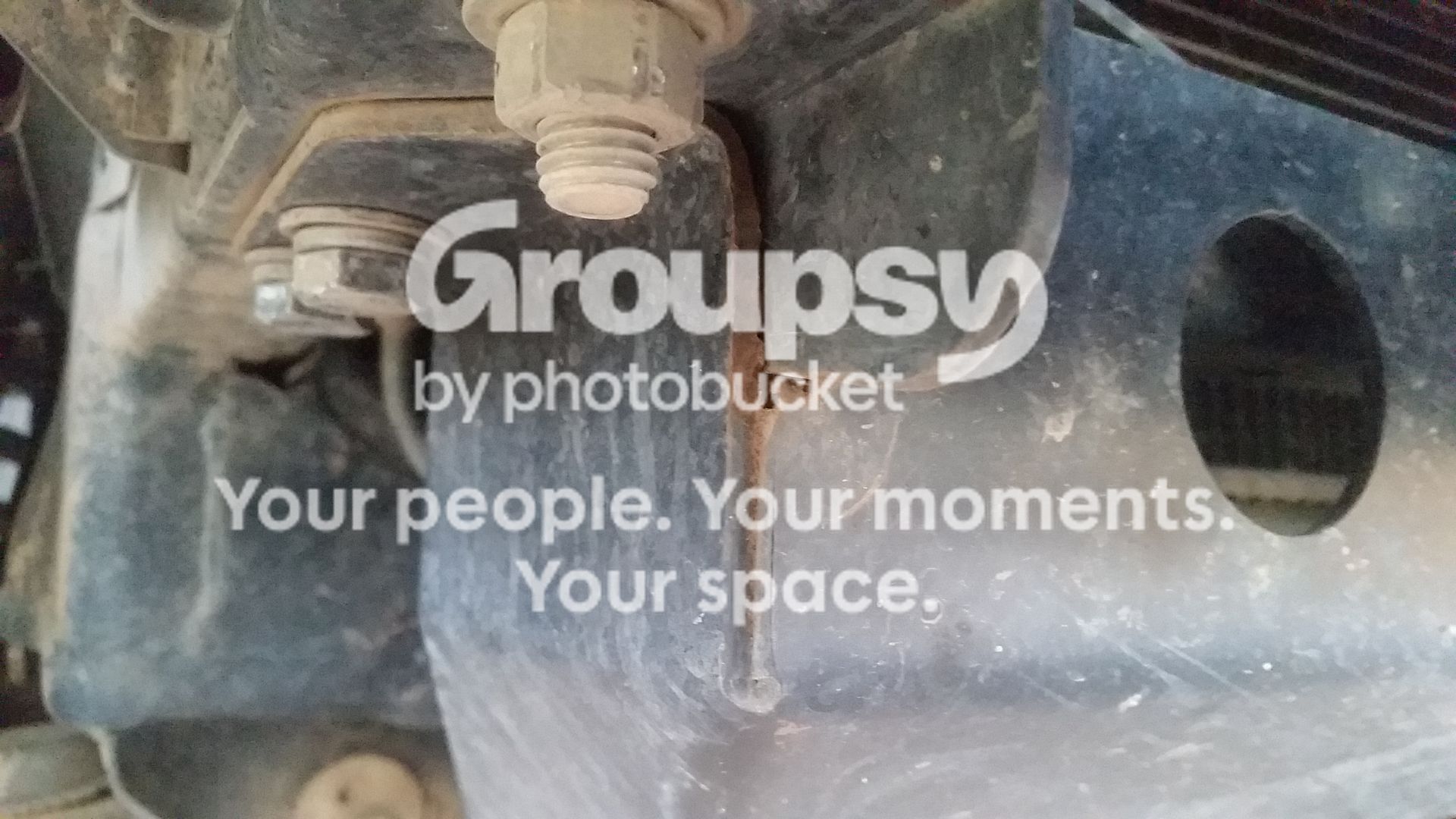

Here you go. All I did to make it fit was to hacksaw the skid a little so the bumper mount would fit though.

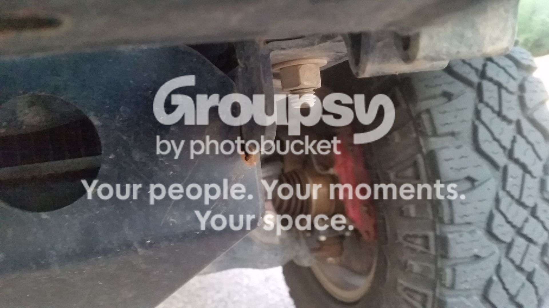

Now for the interesting picture. I was surprised to learn these two bolts are no longer with my 4runner. Crazy!
Definitely looks do-able. Thanks so much for those pictures. Nice 4Runner, by the way. Are those AZ plates I see??
Your welcome and it is completely doable. I did it in 30 min by hand. Yes, that is the AZ state flag. I think it looks good on the front of a vehicle and it covers my winch hole.
