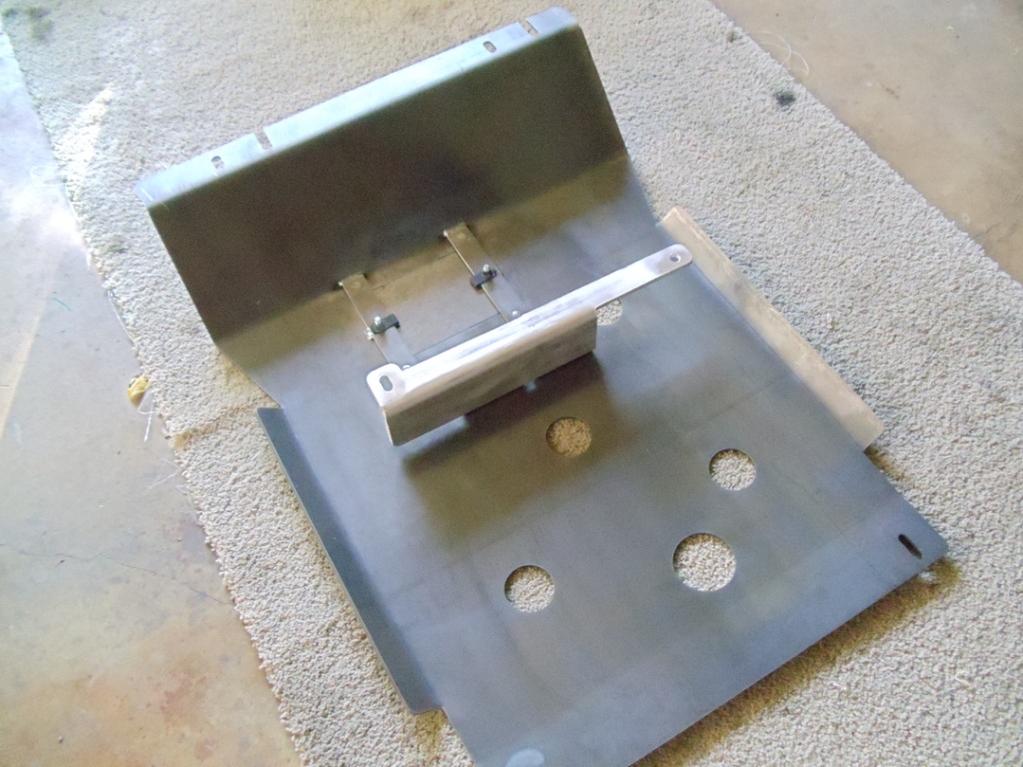

One major thing I prefer about Bud's is the part on the front skid that transfers load to the cross member, instead of caving in the skid plate and oil door. RCI should incorporate something similar.
Bud's also have better protection for the alignment cams.
Bud may not be at the FJ Summits since he is based in North Carolina.....however, he has been a sponsor in the past. When I went to the FJ Summit I was hoping Bud would be there, however, I would imagine as a small business owner it would be difficult to break away for a cross country trip. Bud's products speak for themselves IMO.
RCI has an aluminum piece that braces the skid from the crossmember. But I have thought about reinforcing and welding the oil filter access door shut and replacing the aluminum brace with a brace like Bud's. For the 1 oil change per 10,000 miles I remove the skid anyway so the dealer doesn't get oil all over it.

The access door should be deleted. It is useless IMHO.
Josh keeps improving the design and taking feedback, so they keep getting better. You actually feel like a customer with him. Maybe bud-built is the same, I have no idea. I seem to remember hearing they were sometimes hard to get a hold of.
I think I will weld my oil filter door shut permanently and add a little more bracing to avoid the side to side shift that can take place. So far it is held up fine, but I probably don't abuse them like some people do. I have drug them many times, but have not dropped down on them, YET.
