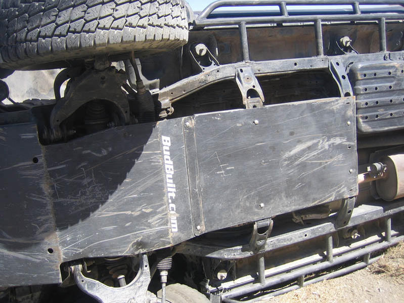

This guy was nice enough to roll his rig over so we can see his Budbuilt skids.

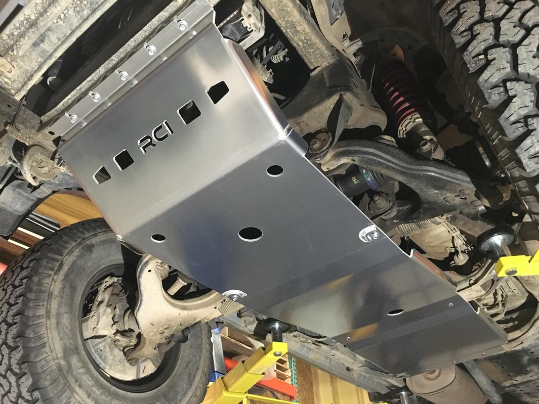

Solid pic
[MENTION=140174]ADK Explorer[/MENTION] what a great pic for us all to see of the RCI skids. I was on their website and could sort of see the full package but this really depicts what's covered.

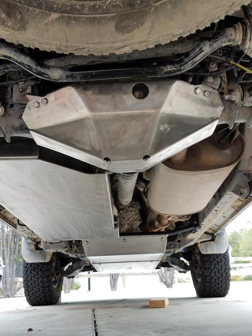

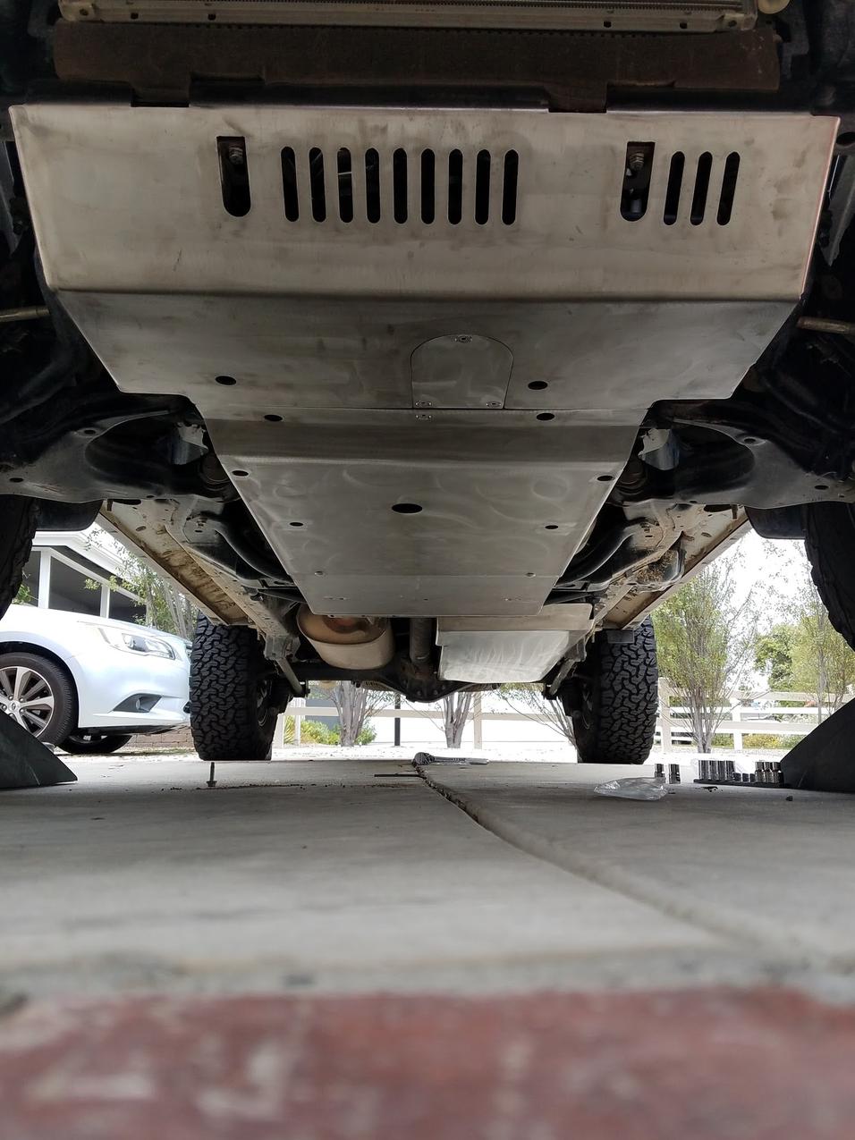

I just installed the BudBuilt 3/16" stainless steel skids and thought I'd contribute with some pics.
Front view (showing front skid, mid skid, tranny skid).
Rear view (showing diff skid, fuel tank skid and cross member).
I chose BudBuilt based on user reviews, and even though my expectations for quality were high, this set of hardware left me impressed every step of the way through the installation. Bud's either a genius, either he spent the last 7 years designing and improving this.

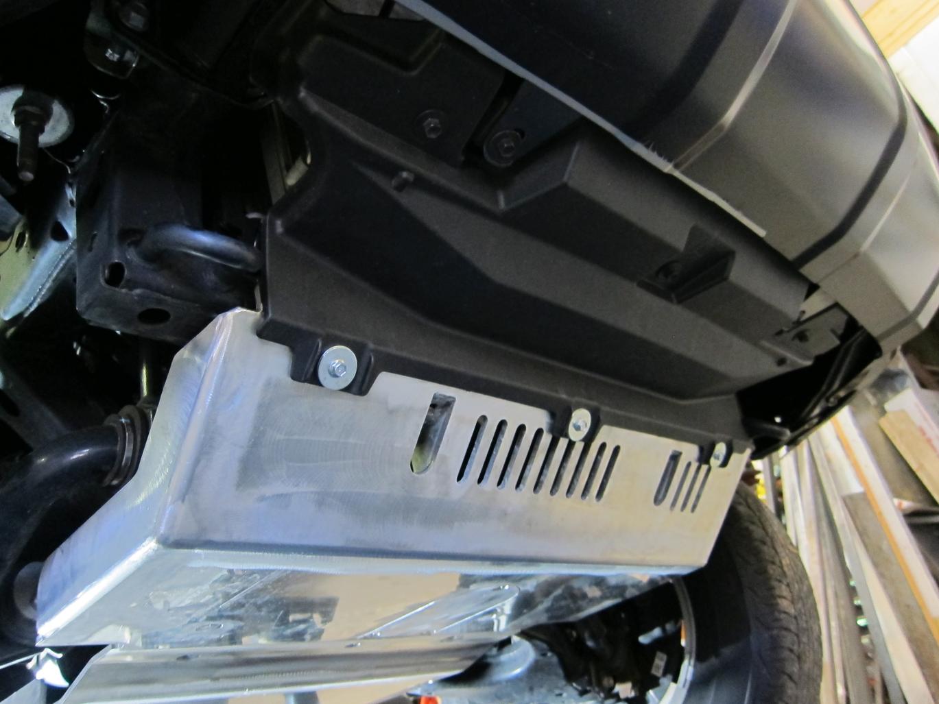

pics of BudBuilt skids we installed today. I was very pleased that we were able to keep/incorporate the factory stone guard (or whatever it's called) into the front skid.
