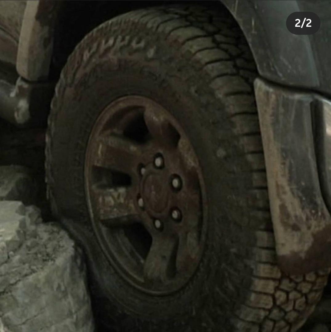

I have the SL rated 265/75 wildpeaks and I have the perfect picture to show sidewall flex. I have never had an issue with mine. My wheeling I mostly mud and rocks. Granted its nothing as extreme as out west but I've never had an issue with them at all.
The photo above is at 15 psi
