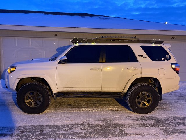

I went through this same decision making process, the difference being I also lifted my 20 ORP by 1.5" all around. I went with the 275 Falken's after deciding I would be willing to sacrifice the weight difference for the extra ~1" in tire size. I am super happy with my decision, and TBH, I do not notice the weight difference whatsoever. Note that I do not pay much, or any, attention to MPG, but in road driving and off road, the weight has not been noticeable.

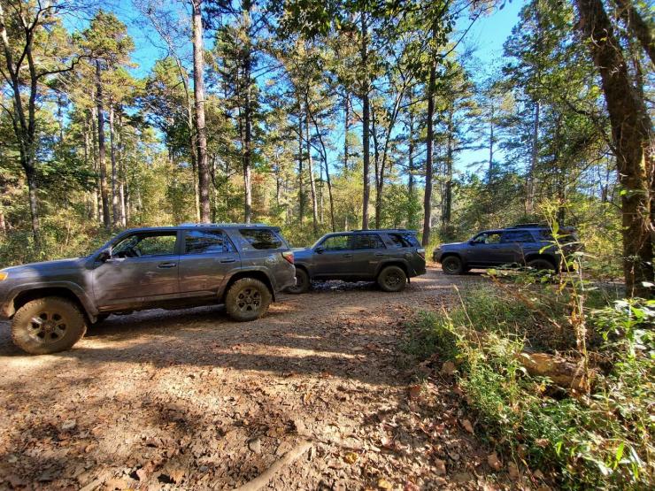

A fellow in our group that met at the recent Rendezvous in the Ozarks had 275 Nitto Terra Grapplers on his 4Runner. They looked bigger / filled out the wheel wells better than my 265/70R17 SL Falken Wildpeak A/T3W's.
His is the SR5 on the far left, mine is on the far right. The middle 4 Runner has stock Duellers.
