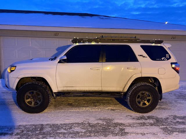

Install completed today of the Toyo AT3 265/70/17 SL. I watched them do the balancing and all tires/wheels didn't take much weight at all, so was happy about that. I'll get some pics, but I can tell you the look didn't really change much, just happy to get rid of the original Nitto TG.
They aired up to 38PSI, ride and noise changes were immediately noticeable. There is a low AT tire sound as you would expect (as compared to road tire). Very significant reduction in tire noise from the Nittos. Also, the vibration is gone when I come to a slow/stop. With the Nitto's I had that wheel shake at 60mph or so, it really wasn't bad, but was present. Yep, tried the wheel balancing, alignment etc.. I just think those Nitto's have/had some issues.
So far, the 60mph shake is gone and am very happy with the immediate/noticeable improvements, but time will tell.

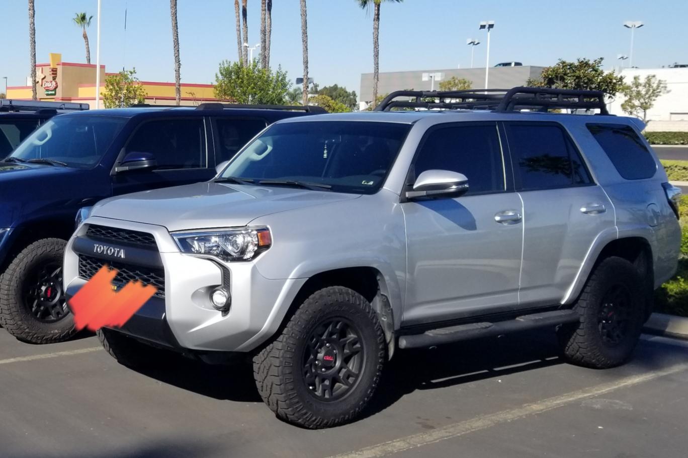

after a lot of reading on here I went with 265/70/17 stock size Falken but the tire shop had a hell of time getting them not to shimmy between 55-60 mph so after few visits back to the shop to get it right they upgrade or trade it out to Goodyear Duratrac very happy with them they appear way bigger than stock size. I also lost about 20-25 miles per tank full with AT tires
the blue rig next to me has Falken on the same rims so you can see the difference
WOW!! That is the look I'm looking for! Can you tell me if those will fit on the stock TRD Off-Road rim?

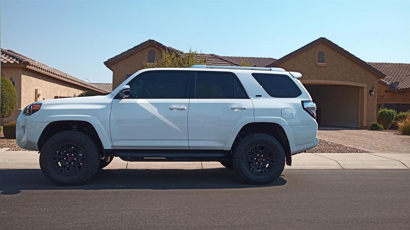

265 Wildpeaks on TRD rims. Truck has the Eibach Pro kit (done AFTER I replaced the tires).

Those look great! Any rubbing?
