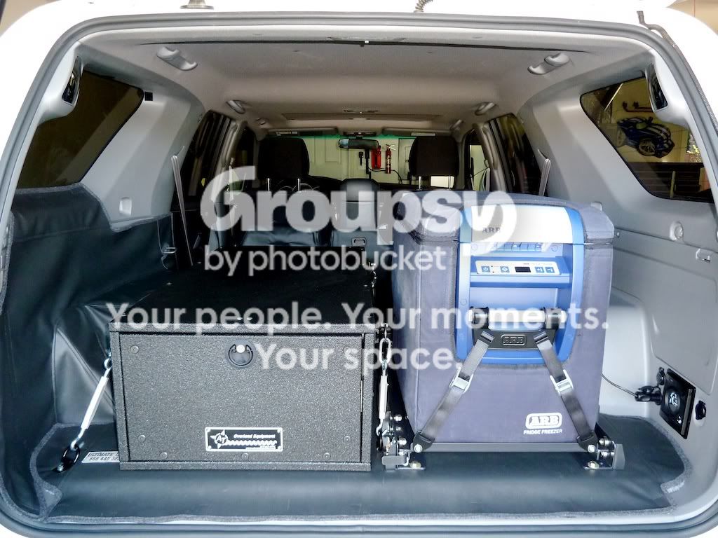

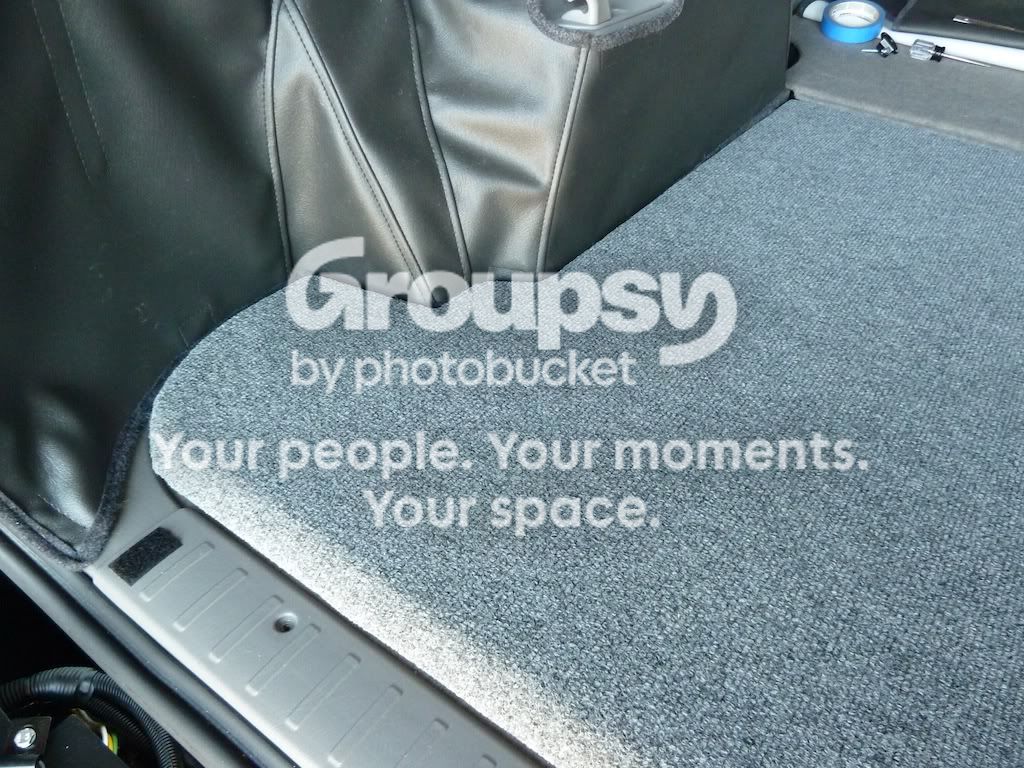

I'm not sure if there is much different between the 3rd and 4th gens that would change much. I have built a couple different versions in my 3rd gen. Before a trip, I wiped out a cheap platform that went over the wheel well and was only a one person. This left a lot of, full height, space for equipment. That height did give more space under the bed but you will feel the roof close to you when in bed. Also it is hard to change clothes in that space. My platform now has a finished height of 6.5" which gives me 32" to the roof. The wheel well bumps fall about where my waist is and I have never had to try to sleep around them. I don't notice them when sleeping.

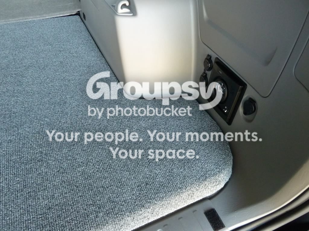

I started out by cutting a sheet of 5/8" plywood to fit the rear cargo area and covered it with indoor/outdoor carpet. The plywood was then anchored to the body at the tie down points.

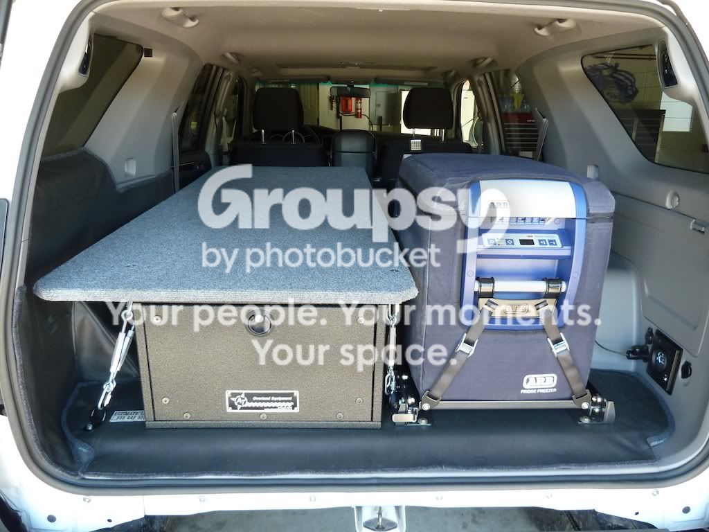

Slide attached to plywood using 5/16" bolts and T-nuts.
P1020523.jpg~original
P1020527.jpg~original

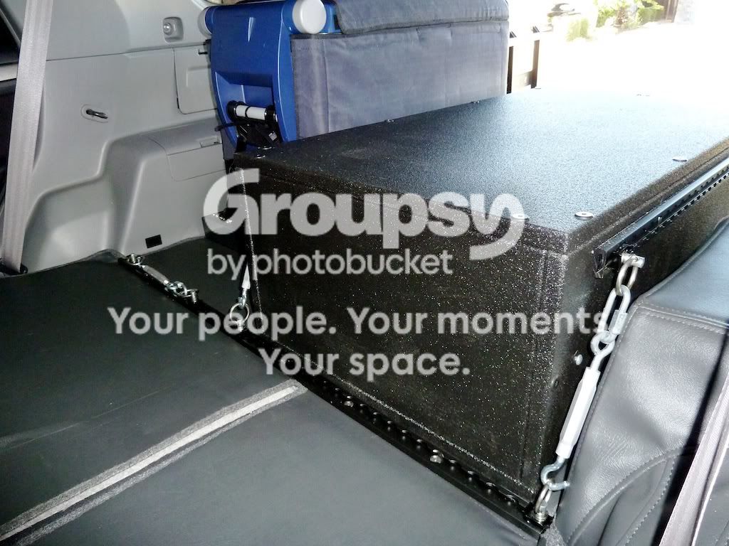

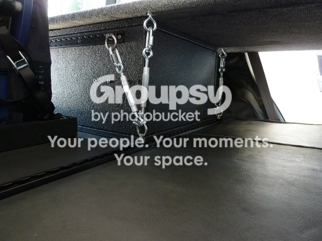

The storage drawer is secured by turn buckles attached to tie down points.
P1020696.jpg~original
A tie down track was installed across the cargo area to secure the back of the drawer.
P1020699.jpg~original

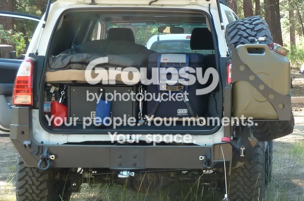

Top off the plywood deck with a Cabelas Cot Pad and a sleeping bag and you're good to go.

I find having a body lengths worth of room on one side of the cot (or whatever) is key for getting in and out of your bed.
My setup is fairly simple. Roll-a-cot on one side, Thermarest and sleeping bag on that. Most of my gear and cooler fit under the cot. The rest goes in the front seats, while I'm in the cot.
I've spent 40 nights in the back of my 04 4Runner in the last 4 years. One of the nice things about this set up is it breaks down pretty quickly. Everything stores nicely behind the rear seat when not in use.

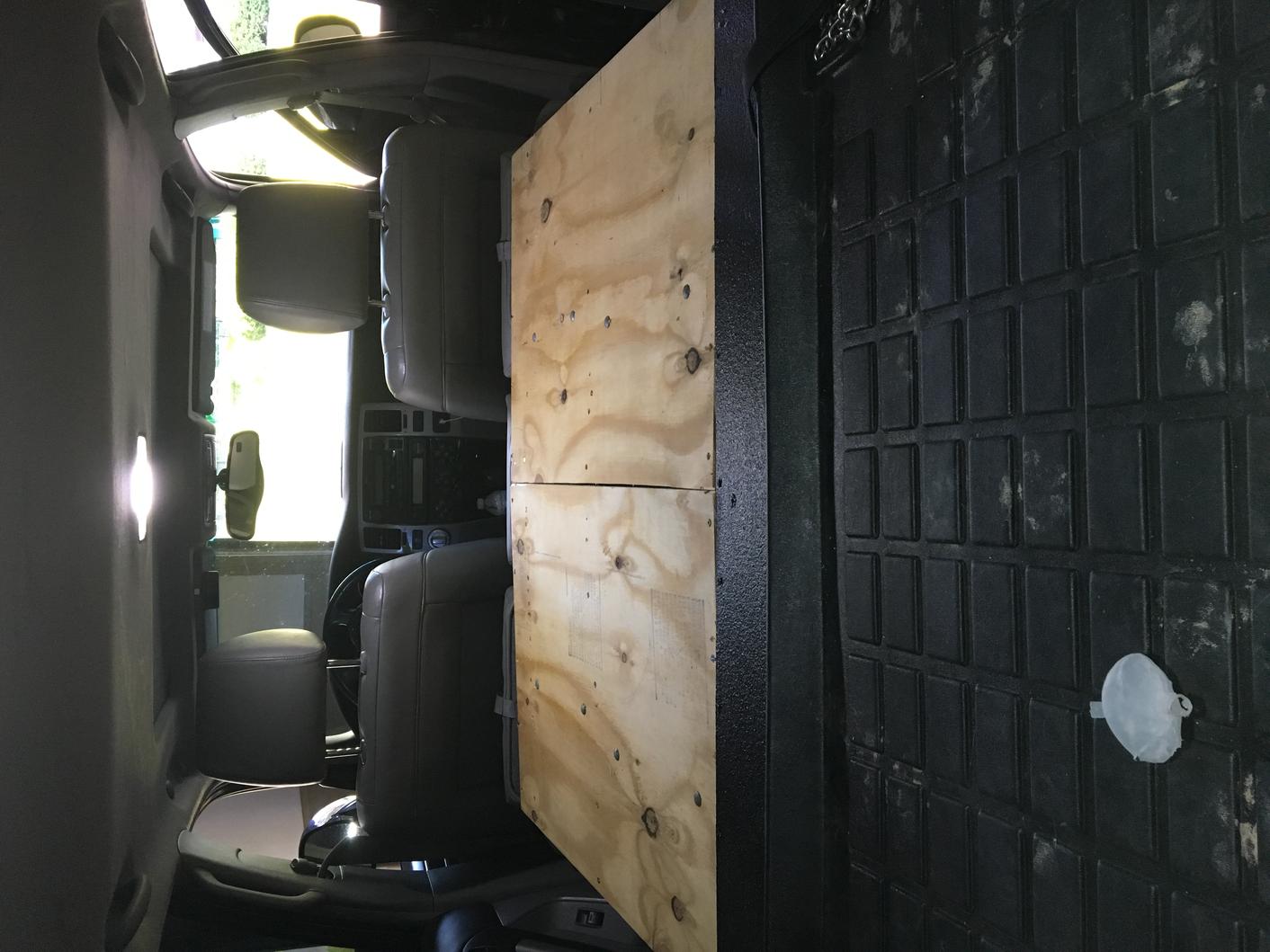

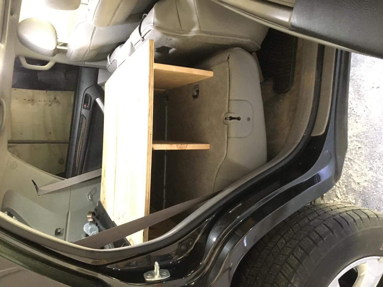

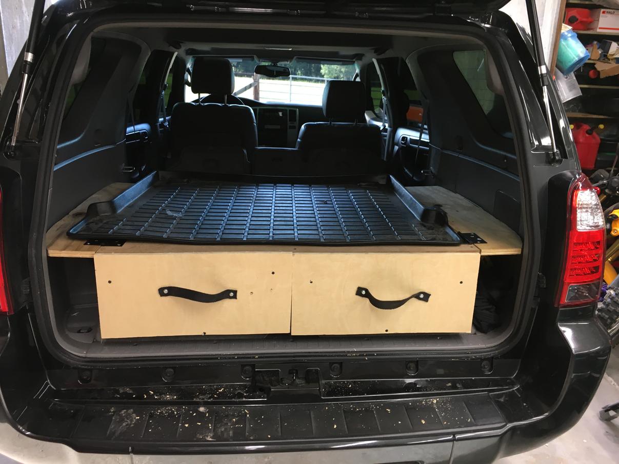

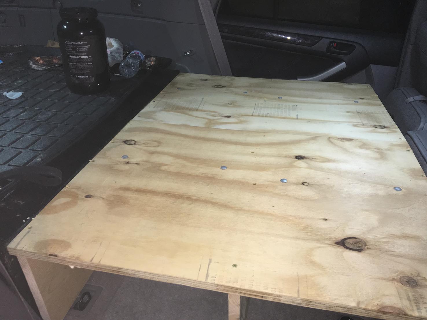

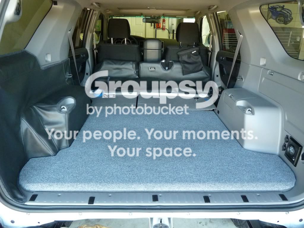

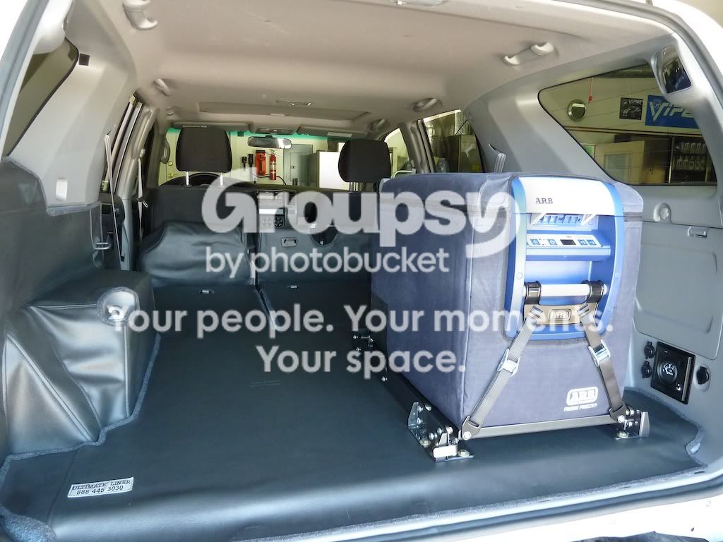

I built this to go with the storage box I had already built myself
It's a 41" sheet of plywood split in half so there's 2 21" sections for easier removal and they are held together when in the car by 15" tarp straps attached to some carriage bolts
I built it to align perfectly in height and width with my storage box which is removable but for the most part stays in the back of the car. The sleeping addition takes about 5 minutes to put in and even less time to take out
It has all been sprayed with black Bedliner but I don't have a picture of that yet
