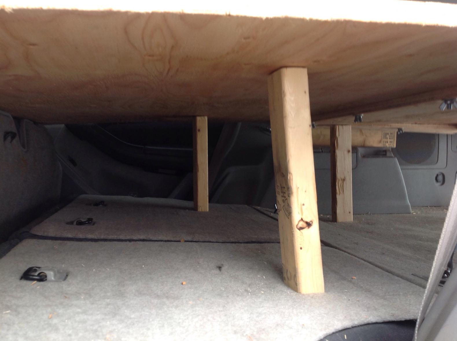

Here some pic of my new sleeping platform!
Total lenght 6ft long and 52 inch wide
Made by plywood 3/4
Project is not finish ill send more picture soon

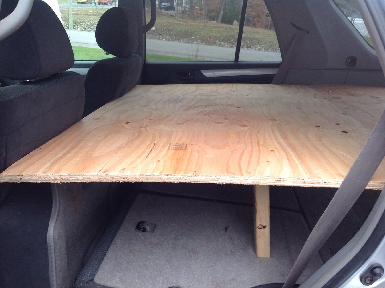

Dont Forget everything is removable and the Deck is spice in the middle.

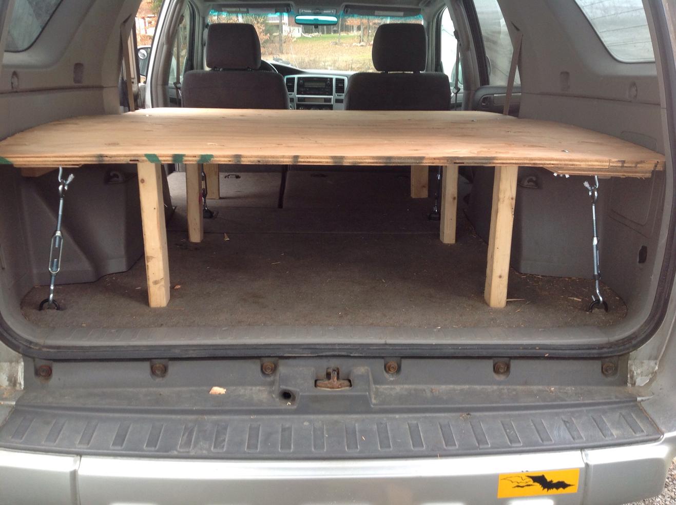

I estimate it weighs about 60lbs. Does it move around or rub at all when you are driving? Is it supported by the wheel wells, or just the 2x4s and rear seats?

As other's have said, at the very least, I would add a wider footprint to those 2x4s so you don't cause any damage.

Looks good, but I have a couple of recommendations/suggestions:
First, IMO that's too high. You're going to have a hell of a time getting in and out of that and you won't be able to sit up at all. It's going to be like sleeping under a bed.
The reason your platform is so high is to clear the bottom cushions of the back seats when folded, yes? OK, you can take those cushions out in literally about 4 minutes with a ratchet and a 14mm socket. Seriously, 4 bolts, 4 minutes max. That will let you drop the platform a few inches and not lose any length.
Second, you really should consider some kind of cross-bracing for the "legs." There are several different ways you can do that, just use your imagination.
3/4" plywood is going to be VERY heavy! I used 9/16ths (1/2) on mine and it seems to work fine. Is there anything holding it down to keep it from bouncing around? I guess if you don't go off-road this isn't an issue.

He has four turnbuckle type things to the cargo tie down points in the trunk.
